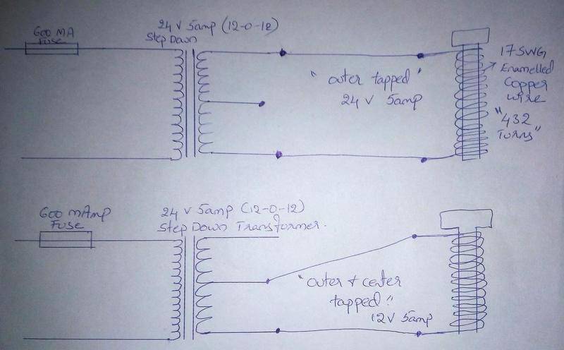

Hello every one I’m a newbie to electrical stuff (I do have basic knowledge) so please be patient with me, please help me! :frown:
So, coming to the details of my diy project I’m trying to vibrate a metal string with an electromagnet. so, after an ample amount of research I’ve made the electromagnet with the following specs.
  • I’ve took an iron bolt 1-inch in diameter and 5 inches length,
  • I had half kg of (about 30 meters) 17 gauge (SWG) enameled copper wire and wound it for about 432 turns.
The specs of this copper wire are as follows:
o Diameter 1.46,
o The ohms per meter is 0.0109,
o It can carry 6.27 amps.
Brought a step-down transformer (A/C to A/C) with the following specs
o 230v input - 24v 5amps output,
o it’s a center tapped transformer (12-0-12)
I’ve fused the transformer with 600 mA fuse (on primary side :cool:) and everything worked fine (well I’ve expected much more oscillation’s in the string) but after around 5 to 10 minutes I could smell some strange enamel and plastic burning, I noticed that the plastic bobbin of the transformer melting,?:)
I switched every thing off, tried to touch the transformer but I could not place my finger for more than 2 seconds as it was so hot! :mad:
This is how I connected
  • I connected the outer two taps of the secondary to the electromagnet and both the transformer and electromagnet are getting hot pretty quickly,:mad:
So,I tried the following.
  • I’ve connected the electromagnet this time to the “outer tap and to the center-tap (half winding)” for 12v 5 amps output, and the transformer did not get as hot as before, but the oscillations in the string reduced dramatically.
  • I had another 24v 1amp SD CT transformer with 12-0-12, this one also is getting too hot, but when connected with “outer tap and to the center-tap (half winding)” the transformer is not getting as much hot as earlier!
My questions are:
  • Why is the transformer getting very hot? (why when connected to outer two taps only!) :nb) :nb)
  • Is something wrong with the electromagnet that i made?(wire gauge/no of turns) :confused:
  • How do I minimize the temperature in both the transformer and electromagnet? :rolleyes:
  • Am I missing something in the circuit? :confused:
  • I want to achieve more oscillations and amplitude in the string (12v 5amps is not achieving the desired oscillations and amplitude).
I want the transformer to work continuously for longer periods (like 10 to 15 hours or more). :biggrin:
please help :cry: :H
please do find a schematic of what I've done, it may not be correct in terms of the symbols, I'm sorry for any errors.

You've got too much amperage on the output side of the transformer - perhaps more than 6 amps.
You need much more impedance in your electromagnet. You may not be able to get it with 17 gauge wire. I would try 1000 turns with 22 gauge. Also, you should probably smooth down the threads on the screw to allow the wire to wind closely and smoothly over it.

So 30m at 0.0109 Ω/m is 0.327Ω
... transformer (A/C to A/C) with the following specs o 230v input - 24v 5amps output, o it’s a center tapped transformer (12-0-12)
So 30m x 0.0109 Ω/m = 0.327 Ω
Then 24V / 0.327 Ω = 73 Amp. (though the transformer resistance would reduce it .)
But you can see that a transformer which is designed to pass 5 A, is going to be very unhappy with even half of 73 A. The heat generated in the winding is proportional to the square of the current, so even 10A makes 4x as much heat as it should handle, 20A would be 16x too much, etc.

Coil DC resistance (based on 0.0109 ohms/meter x 30 meters) is 0.327 ohms.
230 volt AC primary may suggest 230V household mains at 50 Hz line frequency.
Inductive reactance (AC resistance) = XL= 2πfL.
The big question is, "What is your coil inductance"?
How many winding layers? 5 uniform (not scramble wound) layers ought to fit on a 5 inch length.
You know most of the factors involved - wire diameter, number of turns, coil diameter - but a major unknown in the inductance formula is the relative permeability (μR) of the "iron bolt" used for your core. μR is very nearly 1.0 for air, but ranges from about 5000 for pure iron to 100 for mild carbon steel. This is to say, the largest variables under your control is what exactly the core is made of, and details of how the coil is wound (number of layers, scramble wound versus winding it in even layers, etc.).
The primary fuse didn't cut loose, and 600 mA is about 115% of rated transformer capacity (24V x 5A = 120 VA; 120VA is 0.522 amps at 230V). The secondary had enough current flowing through it to get excessively hot, so the 6 amps @.Scott mentioned seems about right. Disregarding for the moment transformer regulation (the rated 24V fell to a lower, and perhaps quite a bit lower value with your solenoid load hooked up to it), the effective AC resistance would have been on the order of 24V/6A, or 4 ohms. If it were much higher the transformer wouldn't have overheated, and would have cleared the primary fuse if load impedance was much lower.
I'm having a hard time with this (I'm rusty, and quite possibly figuring it incorrectly) because this suggests an inductance of 0.018 henry and an effective core permeability on the order of 2, given 432 turns of 1.46 mm diameter wire on a 26mm diameter coil form, and far from the 1.3 henry inductance and 420 ohm coil impedance a 100 μR core would provide.

I think you guys have hit the bolt on the head . Not enough inductance to counter the applied voltage.
L = μμ0N^2 A/Length but the flux path is only half iron, return path is air , so it'll have maybe twice the inductance of an air core solenoid.
Furthermore for a nonlaminated core like a bolt , relative inductance oops, make that relative permeability μ is far less for AC than for DC . In my experiments it was in the tens rather than the hundreds you get for DC
If your winding surrounds the whole five inches of bolt length
area is pi/4 square inches, length is five inches
Change those dimensions to to metric units and calculate inductance of an air core solenoid that size with 432 turns.
Since half the magnetic path length is iron, by applying the simple reasoning that iron is a short-circuit for flux,
we can estimate reluctance of the magnetic circuit is roughly halved by wrapping your coil on an iron bolt instead of a wooden form.
So flux only about doubles.
That puts a limit on your inductance of roughly twice what you calculated for air core.
Then calculate reactance and impedance. I think you'll find as others have suggested, you are connecting your transformer to a near short circuit.
That's why it overheats.
Any help ?
Likes Tom.G and Asymptotic
Which means the voltage is too high. A dropping resistor or a different transformer is needed. Let's face it, the right transformer is always the way to start.

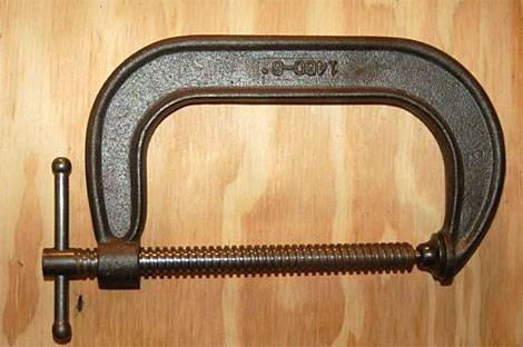

He might experiment with a gigantic "C Clamp" for adjustable air gap.
Likes sophiecentaur and Asymptotic

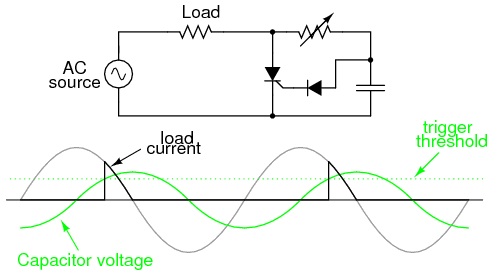

I was hoping for more detail from @PJP on the vibrating string aspect before commenting further, but was thinking it may be in some ways analogous to a material vibrator feeder. A feeder vibrator uses a laminated E core with a winding around the center limb which pulls a laminated flat piece toward it. This flat piece is coupled to the material trough via an elastomeric bushing through the vibrator housing.
When fed with AC they vibrate weakly, but supplied with half-wave and product fairly shoots from them. Thought I'd once sketched out the SCR controller used on the vibrators in question ... not having any luck finding it, but the circuit wasn't much more than this one courtesy https://www.allaboutcircuits.com/textbook/semiconductors/chpt-7/silicon-controlled-rectifier-scr/.
Why not do something like the soldering guns do and have very few turns for the secondary? It could drive the wire to vibration with a permanent magnet, or wind a coil and drive that.
Likes Asymptotic and jim hardy
