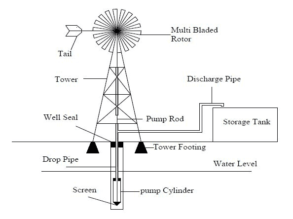

Edit: does it have to be electric power? You could denstrate the principle easier by pumping water uphill.
This is what I was thinking of. In the diagram below, the only thing the windmill does is to make the cylinder move up and down. The windmill could easily be replaced by wave action. It would make a neat DIY demonstration of wave power that you could build yourself.

I really like the water pump design though xD If's definitely a great way to save energy! Thank you for your help
