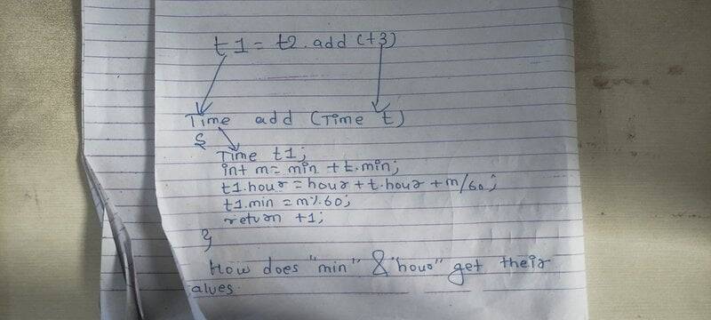

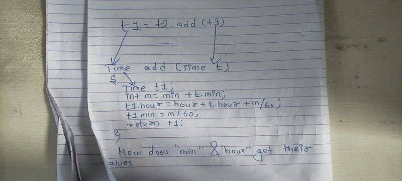

How does "min" and "hour" get their values in this C++ code?
none but I am studying about operator overloading although this is not operator overloading.
Full code here:

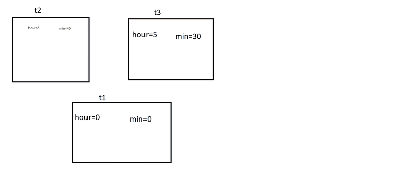

As shown in the figure above, some of my confusions are clear. But what I fail to understand is how "min" and "hour" gets its value from t2(8,40). I am sorry if this is a too basic question, but I didn't understand so I am asking.
If I am missing any prerequisites to this topic, do tell me about them, that'd help me more for self learning.

thanks for the input. but my question remains. how does "min" and "hour" get their values?
This is my question. t.hour means t3.hour, t.min means t3.min I understand.
But how does min=t2.min and how does hour=t2.min?
I don't understand them. Should I just memorize that when we do t2.add(t3) we can access t2.hour and t2.min by just "hour" and "min"? or is there any concept involved behind it?

@shivajikobardan, your Time class has the following:
  • Two data members, hour and min
  • Two constructors
  • A member function, add.
The default constructor creates a Time instance with hour and min initialized to 0. The other constructor creates a Time instance with hour and min initialized to a pair of specified values.
Here are the first four lines in main(), with a description of what each line is doing.
C++:
    Time t1;
    Time t2(8,40);
    Time t3(5,30);
    t1=t2.add(t3);
Line 1 - The default constructor is called to create an object named t1. t1.hour and t1.min are initialized to 0.
Line 2 - The constructor with two parameters is called to create an obect named t2. t2.hour is initialized to 8 and t2.min is initialized to 40.
Line 3 - Is nearly identical to the previous line except that the object is t3, with t3.hour initialized to 5 and t3.min initialized to 30.
Your drawing in post #3 is an accurate representation of what these three lines do, except I can't quite read what you have for t2 as the font is so small.
Line 4 requires a bit more explanation. Here's the code for the add() member function.
C++:
Time add (Time t)
        Time t1;
        int m=min+t.min;
        t1.hour=hour+t.hour+m/60;
        t1.min=m%60;
        return t1;
Line 4 in main() calls the add() function with a parameter of t3. Recall that t3.hour == 5 and t3.min == 30. Inside the add() function, the formal parameter t is a reference to t3, meaning that t.hour == 5 and t.min == 30.
In the body of add(), the local variable t1 is initialized using the default constructor, so t1.hour and t1.min are both initialized to 0.
The second and third lines in add() require some explanation, as it's not obvious what is happening here. Here is how add() was called in line 4 of main(): t1=t2.add(t3);
Member functions (like add() here) have an implied first argument - the object that is calling the method. In this case, it's the t2 object. Inside the add() function, the identifier hour means t2.hour and min means t2.min.
The second line of the body of add() calculates min + t.min (IOW, t2.min + t.min, or 40 + 30 == 70), and stores this valuein the local variable m.
The third line of the body of add() calculates hour+t.hour+m/60 (IOW, t2.hour + t.hour + m/60, or 8 + 5 + 70/60 == 14) and stores this value in t1.hour. Keep in mind that for 70/60, integer division is being performed. At this point in the program, t1.hour == 14 and t1.min == 0, still.
The third line in the body of add() sets t1.min to m%60, the remainder when 70 is divided by 60, so t1.min is set to 10.
The last line returns t1, with t1.hour == 14 and t1.min == 10.
The net result of this is that adding a time of 8:40 to 5:30 results in a time of 14:10.
