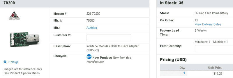

Nowadays the computer is aware of compressor suction and discharge pressures as well as air temperatures.
So it could modulate dampers to hold desired temperature. Should be able to get at them from the Canbus port . ahh another someday project for Raspberry Pi and a Canbus to USB adapter..
not really any help, was I ?
