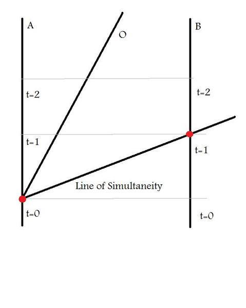

I've attached the space-time diagram, with A, B, and O(bserver) labelled, along with O's line of simultaneity. Observe that, in O's frame, the two large red dots both lie on the same line of simultaneity -- they occur at the same time. One dot is "the clock at A reads t=0" and the other is "the clock at B reads t=1".
Your spacetime diagram is of course correct. The two red dots lie on the same line of simultaneity in O's frame. What does this mean? It means that in the rest frame of A and B, the event that occurs at time t=1 at B is ascribed time t'=0 by the observer, since it is simultaneous with the event at the origin. As seen from the observer's frame, the time at B is lesser than the time at B in the synchronized rest frame of A-B. Let's also draw a line of simultaneity that passes through t=0 at B. It could be seen that this line passes through the t' axis lower than t'=0. That is to say that the event at B at t=0 is ascribed a time t' that is lesser than 0 by the observer. So the observer sees that along the x-axis of frame A, the time shown by the clocks are lesser by vx/c^2 than the time shown by the clock at A. This time has to be multiplied by γ, because the clocks in frame A run at a rate lesser by a factor γ.
