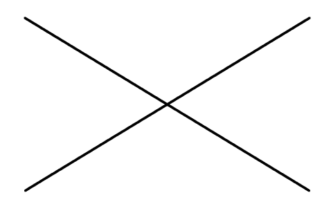

Here is an example of the plane with two lines (imagine the lines being extended to infinity)
How many different regions do you find?
mfb said:
There is nothing in the plane.
I find 4 regions. Sir, but it is mentioned that the regions are formed after removing the lines. This is what confuses me. and the region have "connected components" what is there to connect if the lines are gone ?

The set of all points of the plane minus the points of the lines has different regions - four in the example above.
"Connected" refers to the points within such a region, not between regions.

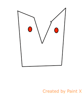

Since the lines need not be of finite length, above figure is possible. there are 7 lines and 2 regions here. But the inner region is not convex as per the red points.
So this proves there can be non convex regionsOr is it that "line" means infinite length and "line segment" means finite ?
In that case i don't think there any way to have non convex regions Now the question is to find the max number of regions that can be formed with n lines(with no two lines parallel).

I'm quite sure the lines do not have end, otherwise the problem is ill-defined.

OK, let's see. No lines, one region. One line, two regions. Two lines, four regions. Three lines, seven regions (unless they all pass hrough the same point, giving one "region" of zero area). Now if you have n infinite non-parallel lines, the n+1th line will cross each of these lines (passing from one region to another) once, i.e. it passes through n+1 regions, dividing each in two. Therefore the number of regions N(n+1) = N(n) + n+1. Looking at the first few values we see that N(n) = n(n+1)/2 + 1. Thus N(n) is O(n2) (I think; I have just looked up Big O Notation, never having heard of it before). It seems to me they must all be convex, but I don't know that I could prove it. I suppose if you had a concave region as in the diagram above, those two lines must extend beyond their point of meeting to intersect other lines, and that "region" would be divided into multiple convex regions.
Right.
For a more formal proof that the regions have to be convex: Assume they are not. Then there are two points A,B in a region where some point between them has to be a border of the region, i. e. part one of the n lines. You can show that this implies that A and B cannot be in the same region.
border of the region which is a line is boundless and that prevents A and B to be in the same region. Right ?
Right.
