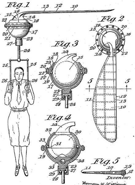

What size propeller is required to lift a 180 lb person 30ft into the air consistently? Also, how powerful would the motor have to be to lift itself, the propeller, and person?
Are you trying to build something like this:
Likes B0b-A and Quinton Powell
Not quite. I am looking for a 2 bladed prop. This is a theoretical question at this stage.
I think you can google "static thrust calculator" and find what size of propellers and motors are available.
From the Wikipedia page on mechanics of helicopter flight:
For stationary flight, out of ground effect, and for a helicopter weight F
where
is the air density.
The induced velocity needed for lift will be:
and the power (called induced power) :
For example, in the case of a small helicopter of 700 kg mass and a rotor diameter of 7 m:
= 60 kW = 80 hp
