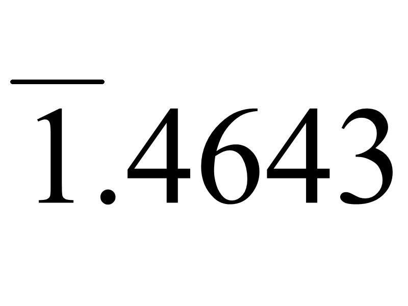

Today I came across a high school math book which has a particular problem in the logarithms chapter. It has
$$ \log_{10}{0.2913} = -1.4643 $$
Trying to verify it with a calculator, I get -0.53566. There's a log table attached at the end which agrees with the calculation made in the book. To make sure there wasn't a typo, I looked up online for the common logarithm table and found tables that agree with it. Trying to verify the book's calculation, I got (with a calculator)
$$ 10^{-1.4643} = 0.034332 $$
Now am I missing something or is it something wrong with the logarithm tables I have? Admittedly, it has been a very long time since I last calculated logarithms using a table.

That is a very odd error, as it is off by nearly (but not exactly) 1. Are the logarithm values next to it wrong in a similar way?
Does your logarithm table really have exactly this entry?
It is off for the next value in the same problem too. It calculates $$ \log_{10}{0.004236} $$ as -3.6269 while with a calculator I get -2.373044.
Even weirder is that it proceeds to add the two logarithms (which it calculated as -1.4643 and -3.6269) to get -3.0912. Then it proceeds to take the anti-log of -3.0912 and gets 0.001234 (while with a calculator I get $$ 10^{-3.0912} = 0.0008106 $$). At this point I stopped taking the book seriously but thought I'd make sure whether it's a problem with me or the book before I explain it to my friend. o0)
It's written in what we called 'bar' notation in school .
Roughly : number of decade shifts + basic log of number in range 1 to 10
0.4643 is the log of 2.913
log of 0.2913 = -1 + 0.4643 = - 0.5357
You can see why this works :
log 0.2913 = log 2.913 - log 10
Likes FactChecker, mfb and M Saad
Oh. So the bar isn't actually a negative? Why would they decide to write it this way? o_O
Are there cases where the bar notation is useful other than confusing poor unsuspecting readers?
It greatly reduces the number of log values that are needed in tables . All you need are logs for numbers in range 1 to 10 .
There are also some small advantages in making calculations more systematic and in reducing chance of order of magnitude errors in final answers .
Likes M Saad and symbolipoint
Conventionally written down like this :
Likes jim mcnamara and M Saad
