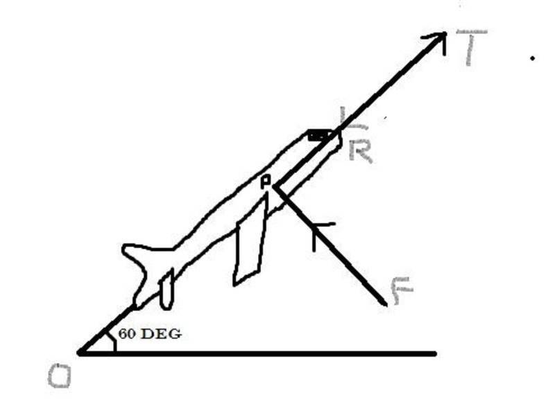

A plane is flying with a constant speed along a straight line at an angle of 60° with the
horizontal. The weight W of the plane is 90, 000 N and its engine provides a thrust T of
120, 000 N in the direction of flight. Two additional forces are exerted on the plane: the lift force F perpendicular to the plane’s wings, and the force R due to air resistance opposite to the direction of motion. Determine F and R.
Can you kindly tell me what steps and formulae should be used to calculate F and R?
Can you draw a free body diagram showing all forces?
O is the startin point. OT gives the direction and magnitude of Thrust. RP stands for the resistance of air ( drag?) . FP is the Force (Lift) that acts perpendicular to the wings. Am sure I've got one or two of these wrong. Kindly correct.
You forgot the weight, otherwise it is all right. Now resolve the forces along horizontal and vertical directions. Can you use the fact that the plane moves in a straight line with constant velocity to write an equality for the resolved forces?
horizontal forces are the resistance of air and the thrust acting opposite to each other.
Vertical forces are the Force of Lift and the weight of the plane acting opposite to each other. Bur how do i derive an equation based on this statement?
The forces due to thrust, air resistance and lift are not purely horizontal or vertical, as they are at an angle to the vertical and horizontal axes. You need to resolve them to these axes, and then use Newton's second law for horizontal and vertical forces.
