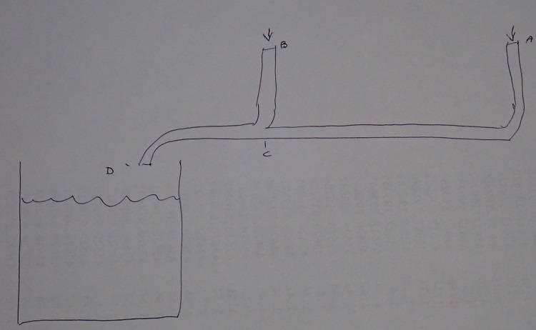

Greetings,
Looking for the best way to calculate TDH for some rainwater catchment systems I am designing in Texas. Some homes we are installing these systems on have large footprints, between 6,000 to 8,000 sq feet. The large rainwater collection tanks we install range between 30,000 and 65,000 gallons and are 7 feet tall. The PVC pipe entering the top of the tank is around 8 feet high. Most soffits/fascia/gutter bottoms are around 8 feet high, so you can see that it is ideal to place a tank for a large home downhill when using 4" PVC pipe. The downspouts for the collection system are all made of PVC pipe, and are primed and glued all the way to the tank so that the system is sealed. The worst case scenario would be to install a tank for a large home and in a heavy downpour, more water backs up into or even our of the gutter rather than goes into the tank because of pipe friction loss. That is a hard repair/fix! I use a 4" rain rate/hr for my calculations to accommodate heavy steady rain but to also not "over design/size" the system for cost.
An example we could use would be 120 GPM that is being collect at the last downspout or closest downspout to the tank, downspout F. The farthest downspout from the tank is downspout A and it only collects 20 GPM from its section of roof area. If the closest downspout to the tank or downspout F is 100 ft from the tank, and the farthest downspout or downspout A is 500 ft from the tank, I get .81 TDH at downspout F and .55 TDH for downspout A. Will the water in downspout A ever rise above .15 ft during a 4" steady rain event?
The downspout that is farthest from the tank has the least amount of water in it but has to travel the farthest. As the conveyance pipes pick up downspouts, more water is flowing in the system. The last downspout (or closest downspout to the tank) has the most water moving past it or in it since it is a culmination of all the downspouts/roof area. My question is, when calculating TDH, what distance do I use? Should I use the distance and elbows from the tank to the tank's closest downspout to figure out how much head will be in the pipes? Or, should I use the distance from the tank to the farthest downspout? Also, what GPM should I use for the farthest downspout? I need to build in some buffer but I also want a CYA for my systems. I was just thinking of using the farthest downspout with max GPM and call it a day, but then again, my mind now wants to know what is actually happening in the pipes but I also want to design my systems appropriately and build tanks at an elevation that is reasonable accurate based on fluid hydraulics. I need some clear PVC pipe I guess!
Thanks!
-S
If I understand correctly, this diagram is a simplified version of your system. I'm assuming that the tank is open to atmosphere, and the water drops into the tank (pipe outlet is not submerged).
You have flow rates, pipe lengths, and number of elbows from B to C, from A to C, and from C to D. Start at D, where the pressure is zero. Calculate the head loss from C to D. That's your pressure at C. Now calculate head loss from B to C, and add to the pressure at C. If the total is less than the vertical distance from B to D, the pipe is flowing properly (not overflowing). Repeat for A to C, then add for A to D.
The key is start at the discharge and work upstream. The pressure at C is determined only by the flow through C. After you wrap your mind around that, everything else will fall into place.

Thanks for the response. The picture is a good representation of some of our systems.
Let's assume that 4" standpipe B has 20 GPM flowing into it, and at point C, there is 120 GPM in the line. Distance of C to D is 100' with no turns/elbows. Distance of C to B is 8 ft. Head loss at point C is .81 ft? For the segment B to C, if the picture is an actual representation, just a vertical pipe that is connected to main conveyance line, how do I calculate head loss of the B to C segment if it is not full of water?

'Head Loss' in the downspouts (like B-C) is effectively moot (as jrmilcher implies). You can't collect enough water for them to be a problem (in a system where the downspouts are the same size as the drain pipe). If the total head (the sum of elevation and friction head) is less than the elevation at 'B,' you can ignore it. If the total head is more than the elevation at 'B,' you're flooding. Either way, what happens at B depends on the downstream conditions (not on the downspout). I'm not even sure that 'head loss' has any meaning for water essentially free-falling down a vertical pipe.
ok, I think I am getting it. Most tanks are at the same grade or lower than the house. In the attached drawing, pardon my chicken scratch, the tank is 2 ft below the house, and the downspouts are 7 feet tall. The pipe entering the tank is 8 feet tall, therefore, the differential (distance between tops of downspouts and pipe entering tank) is only 12 inches. If I did the calculation correctly and took into account the 6 ft and 8 ft increments of the downspouts that are full of water, then downspout B will overflow .24 inches since its TDH is 1.24. Downspout A should not overflow since its TDH is .51. I know I did not take into account elbow, but I am just trying to get the jist of this calculation. In this case, we should design the system for the tank to be another foot lower or raise the house!

You're getting there, but something still doesn't look right with your numbers. Are you using a 'common' pipe to the tank, or are these independent runs? If it's a common pipe: for the case of equal flows at the downspouts (50 GPM) and equal elevations of the downspouts, the upstream downspout will be the first to flood. The head at 'A' should be equal to the head at 'B' plus the friction loss in the 50GPM/100' of pipe (always higher than 'B').
Ok, I understand now. yes, using a common pipe to the tank. I redid my math, here goes: Pipe A should have 50 GPM at 106 linear feet which is .17 feet of head before it joins the next downspout. When the two pipes merge, now more head is going to pipe A, so it would be 100 GPM at 208 linear feet producing 1.21 feet of head. Add .17 and 1.21 to get 1.38 feet of head for pipe A. The water actually backs up or overflow pipe A first. I recalculated head for pipe B and it should be 1.22. I under stand that I need to also include friction loss for the elbows as well. let me know if this seems correct, thanks!

I think you got it.
If you re-read post #3, you can probably now see the advantage of entering the tank from a low point - the water level in the tank replaces the '8 ft' elevation that you're stuck with when entering at the top - You can collect a lot more water when the tank is low. This could complicate the 'cleanup' protocol (described in post # 10) - you'd have to add a blocking valve at the tank inlet. I guess it comes down to how often/hard it rains.
I read Post 10 as saying they already put the block valve in the line to the tank (so the owner can drain the lines after the rain stops). In that case I think the valve would normally be closed (?), and then you might as well enter the tank down at the bottom, saving that 8 feet (as @Dullard suggests in Post 11).
Entering the tank at the top avoids problems caused by leaky valves / fittings, or operator errors. But burying the tank to gain that head is going to be expensive.
