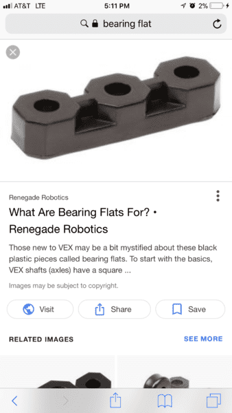

They’re just bearing flats. Here’s a picture.

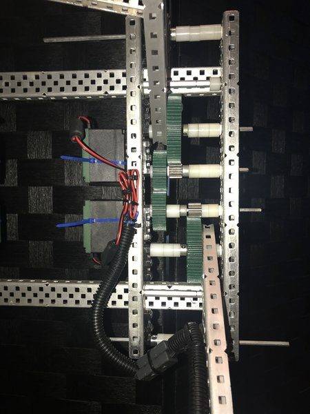

Here’s a picture of the full system. I want to know how to find the minimum force that needs to be exerted by the motor in order to rotate the axle. The cones from the motor and passes through a whole of one of the plastic bearing flats I sent a picture of on both sides of the gear tower. I could probably figure it out if I were using cylindrical axles, but I’m not sure that rectangular axles behave the same way. Thanks.

Dr.D said:
Is this a case of a square shaft in a round bearing, or something else?
Yes, square shaft in a round bearing.
Assuming that there is some amount of clearance (as there must be if it is not to bind up), you will be limited to contact on two edges most of the time (this looks like a recipe for lots of wear!). The contact location will move as the shaft rotates, so the point of application of the friction force will move as well.
Why on Earth would anyone do this? This looks like a bad design from the get-go.

All, below is the link to the above illustration and discussion on "VEX bearing flats".
https://renegaderobotics.org/what-are-bearing-flats-for/
It would appear the root question may be "How much more friction will a square shaft rotating in a round hole have than a round shaft rotating in a round hole?"
If you want to understand more, google "VEX Robotics" which makes robotics erector kits and components; and, the student robotics competitions using robots built with the VEX system.

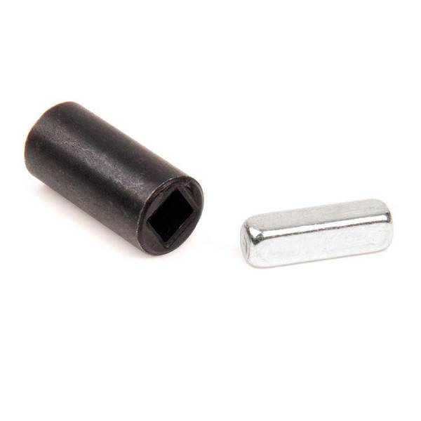

Are the axles actually sharp cornered square section or are they really cylindrical but with four flats cut on them leaving a significant part of the original cylinder intact ?
Likes Dr.D
Looks like that photograph partially answers the previous question from Nidum about the shaft corners. It looks like they could well be part of a circular shaft with four large flats.
Those black axle pieces are intended to be used as axle couplers to connect two axles and they don’t fit into the holes of the bearing flat. I drilled a bigger hole into one of the plastic bearing flats though to see if it would work as a circular shaft and it actually works great.
