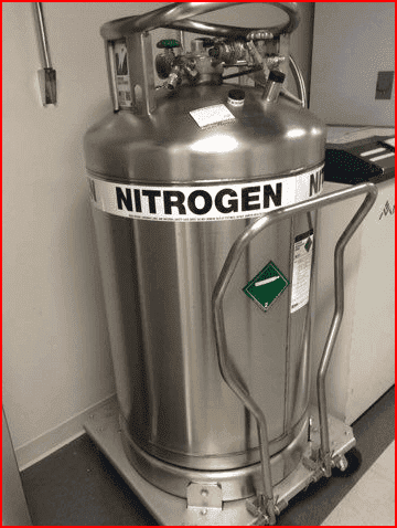

I'm having a hard time picturing what you are describing. This is the kind of dewar I work with. Is it what you are talking about when you say "dewar"? What is your application?
https://media.glassdoor.com/l/74/29/2e/fe/liquid-nitrogen-dewar-shiny-and-new.jpg
242412
No its not this dewar, its more a freezer. Something like this: https://www.alibaba.com/product-detail/SY-LAB-ICE-CUBE-14S-freezer_166562265.html. The problem is i have to put some mechanics on the top of the dewar/freezer and that is why the temperature on the top of the freezer should be over zero and inside the freezer between -150°C and -180°C.
