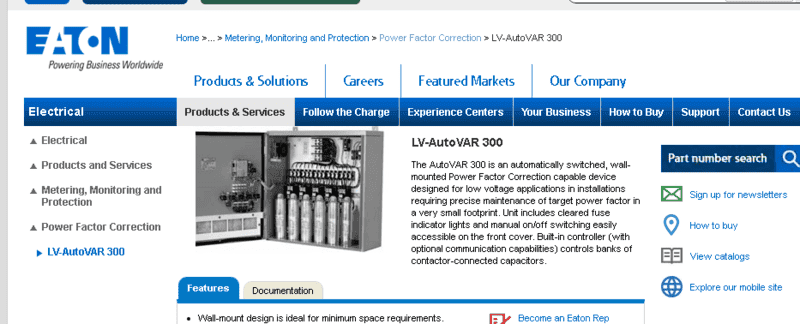

Eventually i think some sort of 'smart' device would be your best bet - it won't forget to 'throw the switch'.
Here's first hit i got from Google search on "dynamic pf correction" , not a recommendation or endorsement, we don't advertise here
just read their brochure and search on the unfamiliar terms. Expertise begins with vocabulary.
http://www.eaton.com/Eaton/Products...PowerFactorCorrection/LV-AutoVAR300/index.htm
