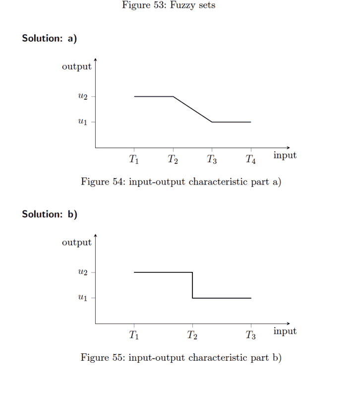

haruspex said:
I see the question but don’t see the solution.
The Solution is there, for example here:
Elias_HH said:
The Solution is there, for example here:View attachment 268987
I'm using an iPad. When I downloaded the PDF yesterday it behaved as though there was only one page. Today it has decided there are several. Strange.
I think I can see the logic.
In a) and c):
Between T1 and T2, it could be cold, but can't be hot, so the output is large only (u2).
Going from T2 to T3, it is decreasingly likely cold and increasingly likely hot, so the output slides from u2 to u1.
Between T3 and T4, it could be hot, but can't be cold, so output u1.
Outside of T1 to T4, no possible input, so no output line.
This seems to work for all the others except e). The question specifies four T coordinates but there are only 3 in the answer, and the output changes at points not labelled. I think the answer should be the same as for a) and c), and it is except for the labels on the axis.
