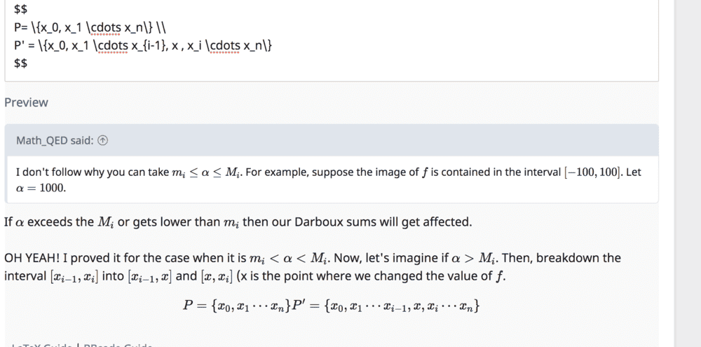

OH YEAH! I proved it for the case when it is ##m_i \lt \alpha \lt M_i##. Now, let's imagine if ##\alpha## is replaced for ##f(x)##. Then, breakdown the interval ##[x_{i-1}, x_i]## into ##[x_{i-1}, x]## and ##[x, x_{i}]## (x is the point where we changed the value of ##f##.
P= \{x_0, x_1 \cdots x_n\} $$
$$P' = \{x_0, x_1 \cdots x_{i-1}, x , x_i \cdots x_n\}
Since, ##P'## contains more points, therefore ##L(f,P') \gt L(f,P) ## and ##U(f,P') \lt U(f,P)##, hence
U(f,P') - L(f,P') \lt U(f,P) - L(f,P) \lt\epsilon$$
U(f,P') - L(f,P') \lt\epsilon$$
##\therefore f## is integrable.

I need one more help, " \\\\ " seems to be not working for line breaks. For example see this image
I have out " \\\\" after writing out the partition P but in preview line didn't get break, it's happening to me from three weeks.
