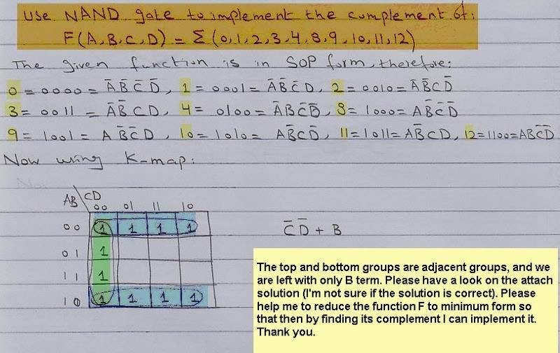

A Karnaugh map, or K-map, is a graphical method used to simplify Boolean algebra expressions. It is a tool used in digital logic design to reduce a complex function into its simplest form with the fewest number of terms and inputs.
A K-map allows for a systematic and visual approach to simplifying a Boolean expression. It helps to minimize the number of logic gates needed, resulting in a more efficient and cost-effective design. It also reduces the chances of errors that may occur when simplifying manually.
A K-map is created by arranging the inputs of a Boolean expression in a grid, with each input combination represented by a cell. The cells are then grouped together based on the function's truth table, and the simplified expression can be identified from these groupings.
There are four main rules for grouping cells in a K-map:
Once all possible groupings have been made, check to see if any cells are left uncovered. If there are any, try rearranging the groupings to cover these cells. If all cells are covered, the resulting expression is in its minimum form. You can also use the consensus theorem to verify the minimum form.
