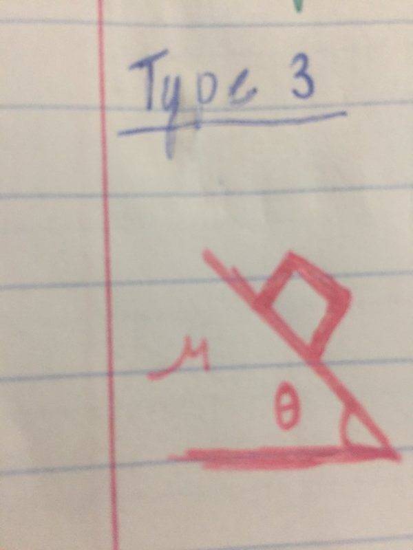

Lab Report - Perform experiment to find acceleration of a cart on three different types of slopes: Flat, Inclining, and Declining.
Type 1(Flat): a = m2g - (coefficient of friction)m1g / m1 + m2
Type 2(Inclining): a = T - (coefficient of friction) m1g(cos(theta)) - m1gsin(theta) / m1
Type 3(Declining): a = mg(sin(theta)) - (coefficient of friction)mg(cos(theta)) / m
I am trying to solve accelerations of a cart on these different slopes. I don't understand how it is possible without knowing the coefficient of friction, but my teacher says it is (very cryptically I might add). Can anyone help me understand this? Thanks.

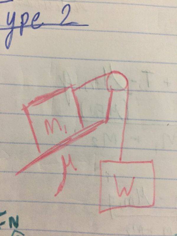

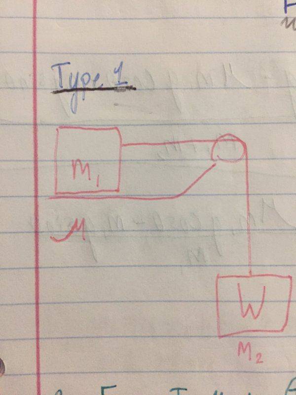

Yes, the experiment consists of a cart on a wooden ramp. The cart is attached to a ticker tape, which runs through the machine to get the period. The other end of the cart is attached to a string, which goes over a pulley and has a 100g weight hanging down. The cart is also 100g.
The first test is with the ramp laying flat. The second, the cart is going up the slope, with the third going down the slope.
With the measurements of the length of the base of the ramp and the height of the ramp's incline, we can get the angle.
Now, I have been trying to figure out how to solve acceleration without having the coefficient of friction. This is my hypothesis:
The coefficient of friction is a control between all experiments. Therefore, I can use the tan function of the right angle triangle to get the coefficient of friction. Is this true or am I completely wrong?
Those are some quick sketches to show how it is laid out.

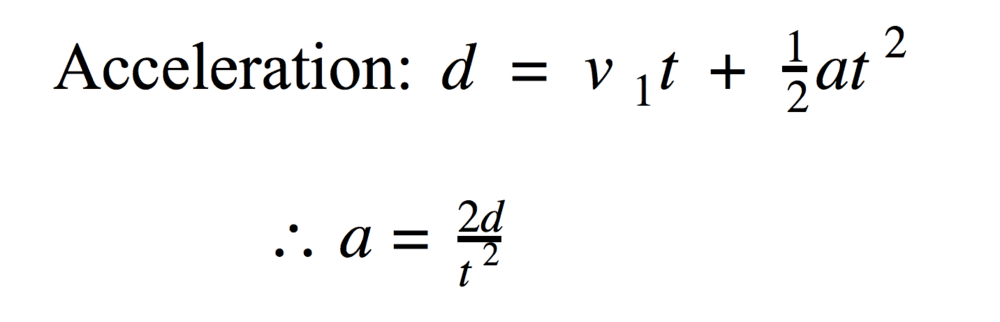

Okay, so what you're saying is that I can calculate the acceleration using the following instead of the circumstantial formulas he gave us?
Or should I use this to get acceleration, plug it into those formulas and find the coefficient of friction, then use that to solve the other accelerations?

are you saying it covered 140 dots in 2.5s? That gives an average speed of 56/s. But for acceleration you need the speed it reached in the 2.5s. Assume constant acceleration.
However, your trig ratios hint says you are expected to be applying some kinetic theory.
Your first and third relevant equations are correct except that you have omitted parentheses in the numerators and denominators of the divisions.
Your second equation is not useful in itself because you still have the unknown T in there. You need another equation involving T for the acceleration of the suspended mass. You can then combine these to eliminate T.
When you have done that you will have three equations in which the only unknowns are the three accelerations and coefficient of friction. So, yes, that is one too many unknowns to solve for. But then you can bring in the measured accelerations and instead have three equations with only one unknown. This means you will get three slightly different values for the coefficient.
What your teacher intends is not clear to me. I suspect she provided more guidance but you did not understand it. In the absence of clarification, I suggest you calculate the coefficient these three ways and compare the results.
