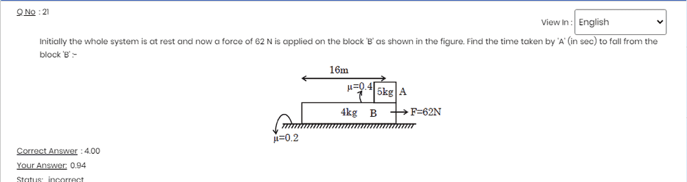

Block on ground with another block on top. All surfaces of contact have friction
$$ F_{net} = ma$$\
$$f_{s} = u mg$$
$$ \frac{62 - .4mg + (.2) (m_{net} g)}{m} = a(t)$$
And, then I put ths into
$$S=\frac{1}{2} at^2$$
But, my answer is not quite coming with what's in the options?

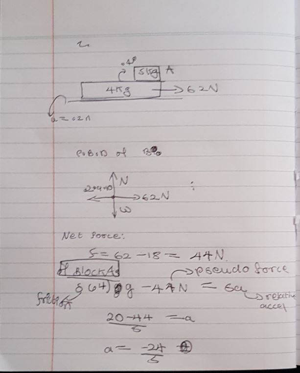

Ok, so I realized I was making some fundamental mistakes, I tried doing it all again, and this is now what I got. Does my application of pseudo force now seem correct? I tried to work in a frame relative to the block on bottom i.e block B
Still not correct. You show a "net" force of 62 N-18 N = 44 N. If that is supposed to be the net force on the bottom block, it is missing the force of friction exerted by the top block. Make the correction, then find the acceleration of the bottom block relative to the ground and use that to find the pseudo force acting on the top block. Remember that in a frame where the bottom block is stationary, an object of mass ##m## (e.g. the top block) experiences a pseudo force ##F_{pseudo}=-ma_{bot.}## where ##a_{bot.}## is the acceleration of the bottom block.

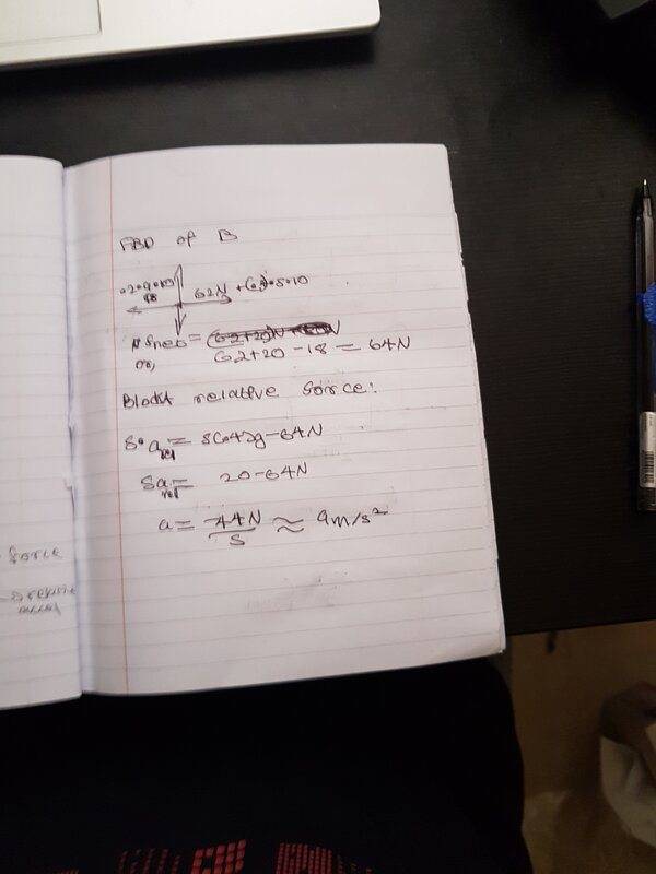

I tried again and I got this, btw is
$$ F_{relative} = F_{actual} - F_{pseudo} =5* a_{rel} ?$$
You most recent work is incomplete. We cannot help you pinpoint your mistakes if you don't show all your work, not just the bottom line.
In post #1 you had a term -.4mg, where I think the m referred to the 5kg. Now this has become +20N. Why the sign change?
The next two lines I cannot read. Please take the trouble to type in your algebra. It makes it a lot easier for anyone trying to help you.
But I think you are then subtracting the 64N you (wrongly) calculated from other forces, as though this 64N is the pseudo force to be applied to the top block. It is not!
When you have correctly found the net force on the lower block you can use that to find the lower block's acceleration. Then you can multiply that acceleration by the top block's mass to find the pseudo force on the top block.

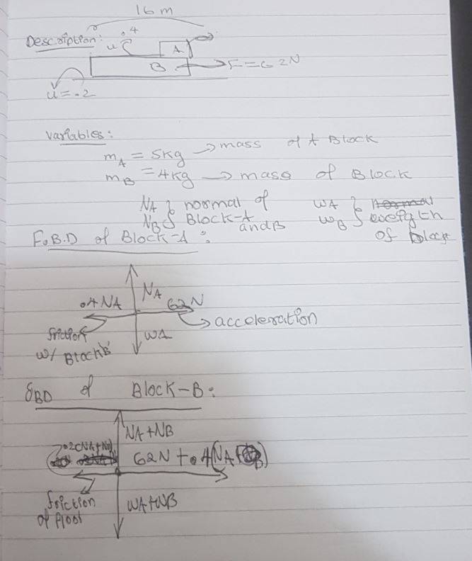

NOTE: signs to right are positive, signs to left are negative
In the bottom block, net force is,
$$ F_{B} = 62 N+.4 (N_A ) - .2 (N_a + N_b) = 62 + .4 * 5 * 10 - .2 ( 5*10 + 4*10) =62 + 4 *5 - 2(9) =64$$
$$F_{A} = 62 N - .4N_{A} = 62N -.4 * 10 * 5 =42N$$
Now in the non inertial frame of block-B, the acceleration on block-A,
$$ 5*a = 42-64 $$
$$ a = \frac{-22}{5} =- 4.5$$
Now does my acceleration seem right?
$$ F_{B} = 62 N+.4 (N_A ) - .2 (N_a + N_b) $$
You still do not have the signs right here.
Which way is the top block accelerating? What force makes it accelerate? So which way is that force acting on it?
What exerts that force on it? So what force does the top block exert in return?
