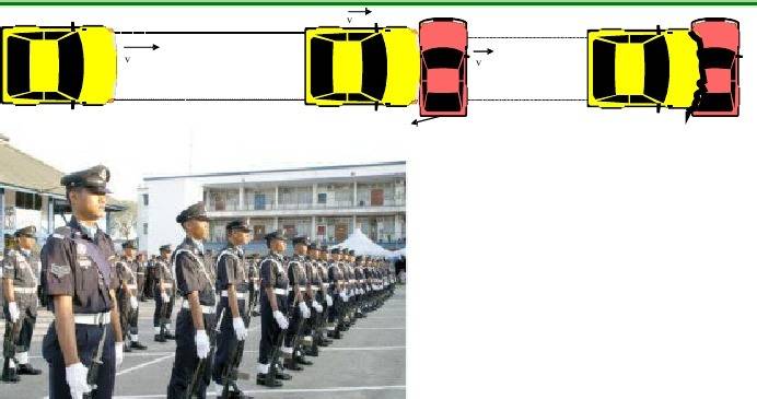

Welcome to Physics Forums. I'm going to copy-and-paste the problem statement, just because that makes it easier to discuss here.
You are just starting a summer job for PDRM collision investigators. You assist theinvestigators in order to determine, as accurately as possible, the circumstancessurrounding collisions (initial velocity of the vehicles involved, direction vehicles wereheading, etc.) in order to take action against drivers at fault under the Criminal Code(dangerous driving causing death or other charges). The job is demanding and your help ishighly appreciated. The weather is great, it’s July, and youarrive at the station as your boss tells you,“Hey, Rookie, hurry over to Kangar Street. There has been an accident involving twocars. There are people injured.” Listeningonly to your courage, you rush (althoughcarefully) to the scene of the accident. Your job is to take photos of the vehicles as theyare positioned, and take a certain number of measurements, including the length of theskid marks and layout of the debris. Youimmediately draw the following sketch of the accident and include a few common measurements.
Left: Vehicle 1 starts braking - - - - - Center: Impact - - - - - Right: Final position of vehicles
- - - - - 30 m skid marks for Vehicle 1 braking - - - - - 12.25 m skid marks after impact
Your findings are as follows:
•Numerous debris (broken glass, plastic, etc.) were found at a distance of 12.25 mfrom the cars;
•The two cars stuck together and there are skid marks over 12.25 m;
•There are also skid marks over a distance of 30 m before the debris;
•The posted speed limit on this street is 70 km/h;
•Other data: m1 = 2.674 kg, m2= 1.100 kg

They don't give vi1 because that is what you are supposed to find out.
For starters, I would:
1. Figure out what μ, the coef. of friction, is. You can use the measurements Fvertical=88.2 N and Fhorizontal=75.8 N, along with the usual equation that involves friction force and μ.
2. Figure out how fast the two cars were going after the collision. You can use the 12.25 stopping distance, and what the acceleration must have been given the μ calculated previously.

i don't think I'm right... my physics professor said that i should use the work and KE theorem to solve for mu... how am i suppose to do that?
You are correct on µ. It sounds like your professor misspoke (or, possibly, was misheard? :smile:). Work and KE theorem can be used to find velocities that are relevant to this problem, but that involves knowing µ already -- which now you do.
jshot079 said:
m1vi1+m2vi2 = (m1+m2)vf
What are the unknown quantities here? The next step is to work on finding their values, and the KE theorem will be useful.

Yes, 70 m/s would be wrong, and for two reasons. (1) It's 70 km/hr, not m/s, but more importantly (2) that is the posted speed limit, and we can't assume the driver's velocity was at the speed limit -- we'd already have our answer then, wouldn't we?
Instead, apply the work-energy theorem to find vf.
Work-energy theorem: W = Fnet·d = ΔKE
Apply that to the final 12.25 m distance that the two vehicles travel before coming to a stop.

Let me stop you here.
What is this force Fa? Is it a force that acts on the cars? If you haven't already, draw yourself a force diagram that describes the cars skidding 12.25 m after the collision.
After the collision, the cars are going at speed vf, then the come to a stop (v=0) in 12.25 m. So the speed changes, it is not constant.
ƩFy
FN-Fw=0
FN=Fw
FN=88.2
88.2 N is the weight of the friction block. The cars are different than that, right?
