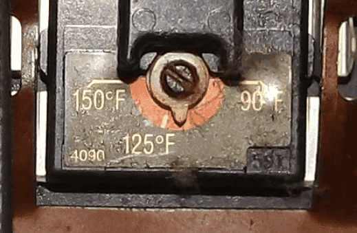

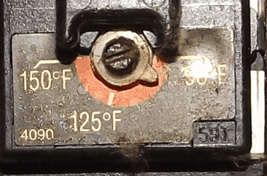

The other thing I tried this year, was reducing the temperature of my water heater, in the summer, to make bathing just tolerable.
summer setting​
It made no sense to me, to have that much thermal mass, just sitting there, at 125°F, just counteracting upon what I was trying to accomplish.
winter setting​
But, of course, in our latitudes, this time of year, 120°F kind of makes sense.

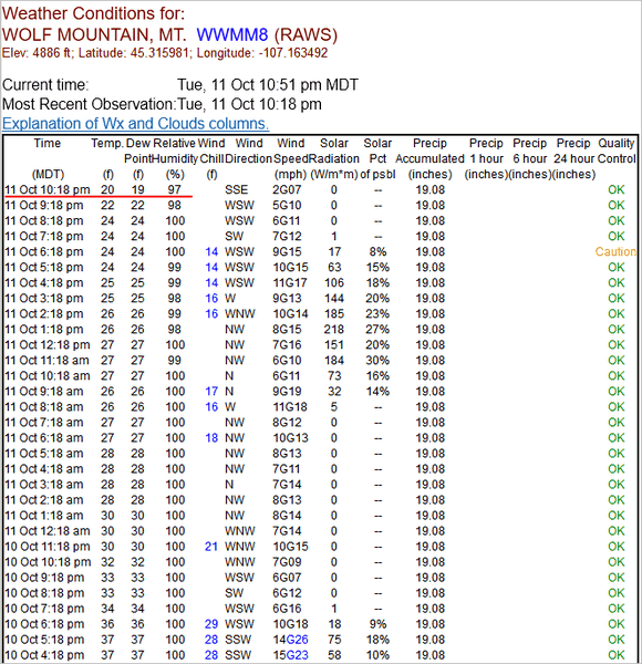

Yeah, as of right now !
It hasn't been very nice around here the last couple of days, about 4 inches of snow, also...[COLOR=#black].[/COLOR] :oldgrumpy:
Likes russ_watters
Hehe - where I live, 20-30F is a common daytime high in the middle of winter.
Another issue that can get complicated is how to heat your home when you have multiple methods available. I generally recommend using a space heater for a bit of spot heating in the room you are in, but if you overdo that, it may end up costing you, especially if you have natural gas fired central heat. If the electric space heater is really blasting, it might cost more to heat that room than it would to heat your whole house with gas.
It hasn't been very nice around here the last couple of days, about 4 inches of snow, also.... :oldgrumpy:
And much colder to come... My ex-inlaws lived in Lolo, MT. I remember visiting there around Christmas one year, and seeing -39° (F) one evening on the temperature gauge at a local bank. The next day it warmed all the way up to -20° (F) during the day. For those who are familiar only with the Celsius scale, -40° (F) = -40° (C), so -39° (F) is about -38° (C).
Lolo and Missoula are laughingly called the "banana belt" of Montana, but only in comparison to areas in the northern part of the state (the Highline) where it can be considerably colder, such as Havre and Cutbank. While Lolo was enjoying the relatively "balmy" temp of -39°, it was -50° F in Havre. And it can get colder there!
Record minimum for Havre in January -- -57° (1916) http://www.intellicast.com/Local/History.aspx?location=USMT0159
