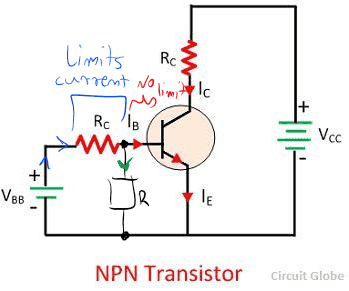

That's right I have problem with basic Understanding of transistors.
I know only the thing I have showed from the tutorials. Like the Picture nr. 1 from post#1.
I just don't get it why transistor works from more complex situations such as Darlington or Voltage divider.
In tutorials or in the websites they say that resistor limitu the current, follow the basic Rules such as 0,7V and done.
Usually what I hear from others is that it is easy only Basics are Requied to Understand every Circuits and from that I usually feel stupid.
So maybe somebody can tell me the basics? Use my pictures to show me that those basics Apple there as well. I need guidance because those transistors are Tricky for me. I want to use them in audio or in LED Circuits but I don't get it.
This whole VC Ve Vb and currents such as Ib Ic makes me confused I don't know how to Approach it or how to Understand someones Circuit that has transistors. Or how to create my own Circuit wity transistors

Re: The diagram in post #24.
R1 limits base current of T1 when S1 is pushed on.
R4 limits base current of T2 when T1 is on.
R5 limits LED1 current when T2 is on.
R2 and R3 (connected between base and emitter), are NOT there to be part of a base-bias voltage divider. When S1 or T1 is off, R2 and R3 will conduct leakage current away from the base without dropping sufficient voltage to turn the BJT base on to any extent.
0.1 V / 10 k = 10 uA maximum leakage when off.
0.6 V / 10 k = 60 uA wasted when on.
Since the supply voltage is many times VBE, the 60 uA will be insignificant when on.
  • #50
@Xenon02 ,
I highly recommend that you draw the schematic as you progress thru this post AND DO THE ACTUAL CALCULATIONS FOR EACH STEP.Please post your results. That way we are all on the same page of the problem, rather than jumping around trying to answer multiple questions that keep changing.
This note refers to the diagram with R1, the push button, R2.
IGNORE THE REST OF THE CIRCUIT FOR NOW!
Since a supply voltage was not given, assume a 10V supply.
PART A:
1) With the button pushed, what is the voltage at the top of R2? (Ohms Law)
2) You stated that you knew Thevenins Theorem.
2A) Based on that statement, what is the equivalent source impedance for the voltage at the top of R2?​
PART B
Now connect the Base and the Emitter of T1 per the original diagram. (we don't care about the collector right now, so you can leave it not connected if you wish.)
3) What is the voltage at the Base of T1?
You now know the (nominal or unloaded) voltage at the top of R2 (Ohms Law from PART A above) and its equivalent source impedance (Thevenin from PART A above) AND the new voltage when the base of T1 is connected.​
4) You stated you knew Ohms Law.
With the equivalent impedance from #2 above, and the change in voltage (#1 & #3 above) at the top of R2.​
4A) How much Current is flowing from the bottom of R1?​
Discussion:
Because it is so low, in Almost all cases the current thru R2 can be ignored when the transistor is connected. For simplicity, we will therefor assume that all of the R1 current flows to the T1 Base.
You have now found the T1 Base current (#4A above). When you multiply that current by the β, Beta, or hFE of T1, the result will be the Maximum current you can expect to flow thru the T1 Collector (providing you don't burn it up!).

Okej. But can I also use picture nr.1 from Post#1 as a reference to why I am confused ? Because all my confusions came actually from this 1st picture.
Those are results, I wasn't sure with Part A because I didn't understand if I was supposed to calculate getting rid of R2 or with R2.
But okey I can see that using this equivelant will make something like this :
But I do have some questions though.
If I can refere to the 1st picture of the Post#1.
I was taught there that Rb controlls or maybe better it limits the current that transistor takes from voltage supply and makes it into Ic.
So in this example I've used the equivelant but in reality the transistor doesn't have any RB or Should I consider R1 as a RB ? Sorry for saying dumb things I am stuck a bit with the 1st picture from Post#1. That there was always Rb.
Second question.
I can undestand that the diode is a priority and the R2 will have 0,7V because of the diode but if there was RE then the voltage on R2 would be more difficult to predict ? I ask it out of making circuits. I'll show later after some analizing a circuit that consist Re and other stuff.
Third question
Okej so the current is calculated for Ic and Ib. But adding new elements to collector won't change anything ?
Because for now I only understood the resistors examples (maybe except the one with Rb and Re, where I couldn't define the Vb and Ve) Adding now transistor won't make things a bit worse ? Now PNP can provide a lot of current. I am not confident when it comes to Adding transistor to another transistor. It is just weird because transistors are usually controlled by resistors but adding transistor to another transistor. I don't get it.

Those are the basic principles ? Isn't it like I said in my post#1 ? That we need to limit the Ib or something like that I said there.

Sure thing I'll use pictures to visualize my vision of it.
Basically I see it like that. There is Rb that limits the current from voltage source that is going into transistor because he himself cannot.
When I see the divider that has this current flow :
And the current is splitted into transistor that doesn't have Rb and it splits also to R2.
Transistor without Rb look like that in my eyes :
Of course the part only with transistor that doesn't have Rb. Because here in this picture the transistor can take any amount of current.
  • #64

I've looked at your diagrams in post #63. Equating the second and third diagrams would be flat out wrong.
Take the first diagram and add a resistor tied to the base and emitter. Why is it you think that somehow by doing that it is the equivalent of having no resistors at all?
  • #66
Add resistor you mean the add it to the 1st picture in post#63 ?
If yes then it would look like that :
Which there is a limit and the transistor that has no limit and another resistor.
Why is it like that ? I don't know because it wasn't covered in any tutorial nor in basics from websites. I just know that Rb there is direct limit for transistor.

Rc limits current no matter what. Are you able to see the schematic that you drew on a resistor is the same as the original with the push button as far as base associated components?
