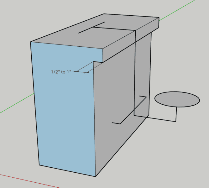

Ideas to prevent falling - Drawing attached
In summary, the goal is to come up with a design that is portable, light weight, and able to support a 300lb person. The product should be made out of a lightweight material that is able to support the load, and should be able to be rotated so that it does not touch the wall. The goal is to reinforce the joints so that they are strong and resistant to bending. angle irons and shelf brackets are good examples of how to do this.
tbaron27
Looking to develop something that will "hang" as shown in the drawing without falling off and without requiring permanent attachment. Any help appreciated.

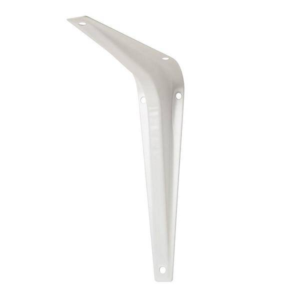

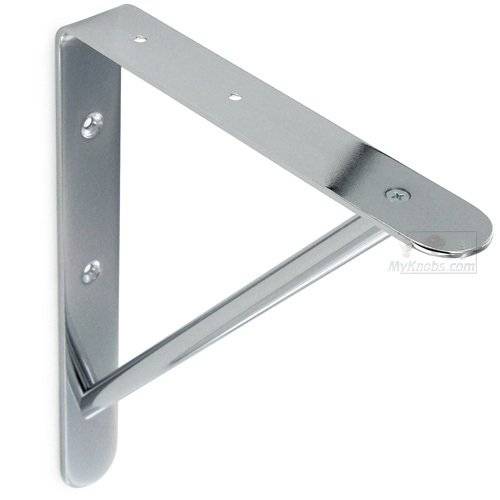

In designing and building structures like this, you should think in terms of triangles and I-beam shapes. using flat pieces for a structure like that leaves the bend locations too weak to support loads. So the top bend should have some I-beam type shaping to increase its strength and resistance to bending, and the lower bend should be reinforced with triangle shapes across it to similarly resist bending.
Take a look at how angle irons and shelf brackets are reinforced to increase their strength against bending. You need to add structure to keep the bend from being "flat". The first 2 images below show ways you could add bracing to the bottom bend, since you have room on the inside of the bend to add triangular bracing. You could use plates or rods welded to the sides of your vertical plate and bottom plate to add the bending strength for the bottom joint.
The 3rd picture shows another way to add bracing, but picture adding the bend or structure to the outer part of the upper bend. You would want to add vertical structure to the outside of the upper bend to add the strength, or else make the top part higher above the top of the wall so you can add inner triangular braces.
And yes, adding some sort of high-friction material like medium density rubber to the contact patches with the wall would be a good idea (and would help to prevent scratches and other damage to the wall.
https://www.bathfashion.com/images/product/large/casrm20pc.jpg
http://assets.rockler.com/media/cat...3525d08d6e5fb8d27136e95/4/4/44162-01-1000.jpg
https://images.homedepot-static.com...bilt-shelves-shelf-brackets-15254-64_1000.jpg
Also, could you comment on the 1/2 inch space that you show for about the bottom 3/4 of the support versus the wall? Why does it have to be away from the wall? It will be hard to keep it from rotating in toward the wall, although if you have good contact with that upper 1/4 and stiff bracing across the full support structure, it may end up working.

I appreciate the info on supporting the bends, however the biggest issue I'm having is how to prevent the structure from rotating off the wall to the right (using orientation from drawing). In regards to the 1/2 inch space between the wall and the structure, that is due to the lip at the top of the wall. I figured I could put a spacer of sorts attached towards the bottom of the downward piece of the structure that would keep it parallel with the wall. But again, what I'm finding is that as soon as I put any type of load on it, the structure just pivots at the point of the bottom bend and the top just falls to the right and off the wall. Make sense?

The clamp I used was actually from the top of the lip on the wall to the bottom of the lip. In this clamping prototype I also got rid of the piece that runs along the top of the wall. For design purposes we need to assume that the width of the wall is infinite and therefore there is no way to clamp, latch or hook onto the back side of it. I just didn't know how else to draw it :-) Here is a 3D drawing that might help better grasp the concept. I added the horizontal bars to prevent side to side sway and to act as the spacer. Never mind, apparently it won't let me paste in the pic or attach it since it's a reply. Anybody know how?

drawing attached.
