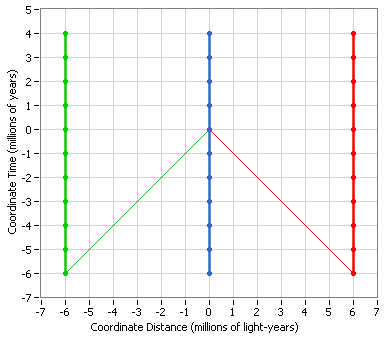

DaleSpam said:
rusststone1 said:
I am just trying to get someone far smarter than I to shore up the fact that if light traveled six millions years, then six million years it is, period.
The problem is that the statement "X took six million years" is an incomplete statement. It is like saying "Bob is taller than", you need something else to complete the statement.
A complete statement would be "X took six million years in Earth's reference frame". If it took six million years in Earth's frame then six million years in Earth's frame it is, period. But if it took six million years in Earth's frame then in another frame it took a different amount of time.
Here is a spacetime diagram in Earth's reference frame depicting light from two exploding stars, each six million light-years away from the blue Earth on opposite sides. The dots mark off a million years of time for each body.
Note that both stars exploded six million years prior to time zero and that it took six million years for the images of the explosions to reach Earth.

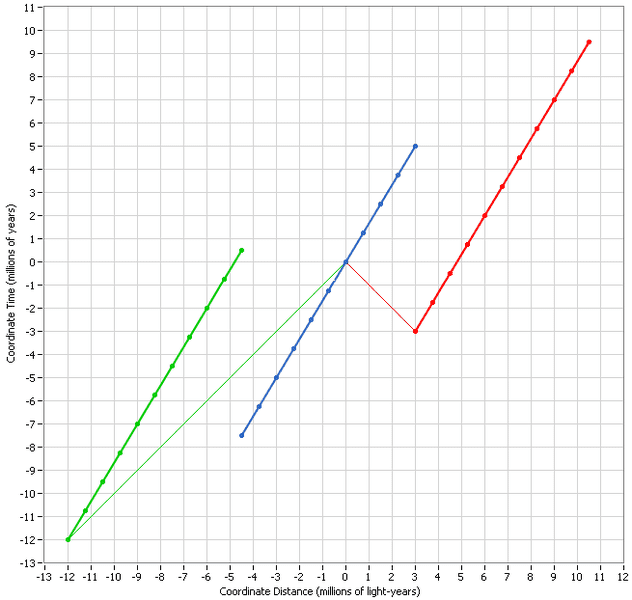

Now here is a spacetime diagram for a reference frame moving to the left of the first one at 0.6c:
Note that the two stars are closer to the Earth by a factor of one over gamma. Since gamma is 1.25 at 0.6c, this puts the stars at 6/1.25 = 4.8 light-years. (You can measure this at the Coordinate Time of 0.) But that doesn't mean that it takes 4.8 years for the images of the explosions to reach Earth. In this frame the explosions don't occur at the same time and as a result, the image of the red star takes only three years while the image of the green star takes twelve years.
Now if we use a frame that is traveling at 0.999998c, we would find that the distance to the two stars would be 12,000 light-years and the time for the light to arrive from the red start would be 6000 years while the time for the light to arrive from the green star would be 6 billion years.
So you can have your thousand to one ratio and your one to a thousand ratio both in the same frame. In fact you can't have only one of the ratios for all the stars in the universe.

I made an obvious mistake in the previous post. I forgot to add on the "million" prefix when talking about the coordinates in the paragraph right after the last image. I should have said:
Note that the two stars are closer to the Earth by a factor of one over gamma. Since gamma is 1.25 at 0.6c, this puts the stars at 6000000/1.25 = 4.8 million light-years. (You can measure this at the Coordinate Time of 0.) But that doesn't mean that it takes 4.8 million years for the images of the explosions to reach Earth. In this frame the explosions don't occur at the same time and as a result, the image of the red star takes only three million years while the image of the green star takes twelve million years.
