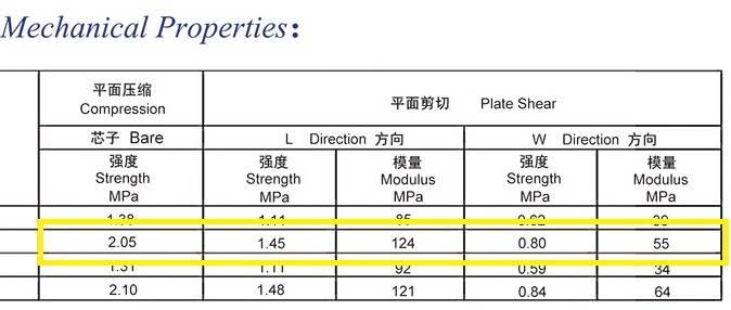

i am doing composite analysis in ansys acp. i am using nomex hneycomb as core sandwiched with 3k twill carbon fiber on each side. i am unable to understand properties that my manufacturer gave. these are lengthwise and widthwise but in ansys i have to enter properties in x y z direction. can anybody help?

i am trying to model properties of each layer. can you please guide me? also i am facing difficulty in importing properties of honeycomb nomex . this is the properties of honeycomb that my manufacturer gave

Those are the compression strength and orthotropic shear modulus for the honeycomb but may not apply to your loading conditions. You're going to need more detailed information to create a model in Ansys. If not available, your other option is to get raw material properties for the Nomex and then physically model the honeycomb geometry.
