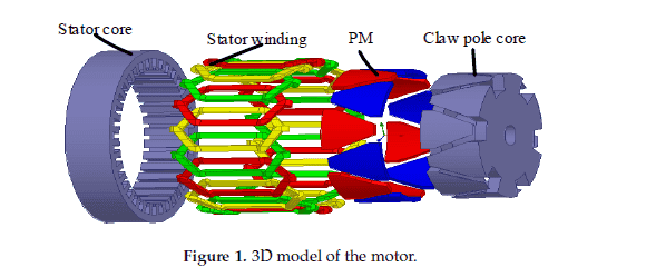

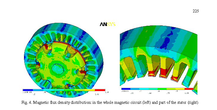

Each stator winding needs to encircle one claw.
. http://citeseerx.ist.psu.edu/viewdoc/download?doi=10.1.1.619.1892&rep=rep1&type=pdf
mdpi.com/2075-1702/4/3/15/pdf
I do not know what will happen when they do not mesh up. I suspect that because of geometry you will get near zero volts out as voltage induced in some windings will oppose that in others..
