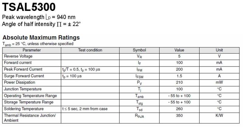

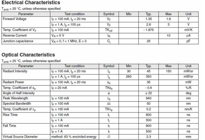

How to improve the signal distance of the IR led?What parameters in the datasheet that we should look into?
I have purchased few IR leds but all of them can't shoot more than 3 metres. I noticed increasing the current to the leds does increase the distance but not by much.The absolute max rating for IF is 100mA and I even pushed the current to this limit but didnt see any significant improvement.
Could it be because of the 950 nm wavelength of the led which limits the distance?
My project does not need signal to go above 1 metre but it would be better if I can get to know on the signal distance a little bit more.

On the IR LED distance question,
1) Use reflective optics to concentrate more of the IR energy at the receive diode. Use a parabolic reflector at the TX IR LED, and a similar reflector at the RX diode.
2) Are you modulating the drive current to the TX LED? You should be doing that, so that you can bandpass the RX energy, to help reject stray IR and optical noise. The better your SNR, the more gain you can use at the RX circuit, and hence the farther your effective range.

So,my only option is to use reflective optics?But what about getting better and stronger IR led?What parameter that I should be looking for at the datasheet that say this LED can shoot,say above 10 metre.
