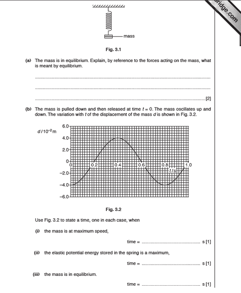

The problem is with part b(ii). This is an A level question so only elementary concepts are to be used.
$$E = \frac{1}{2}kx^2 $$
EPE should be max at 0, 0.4, 0.8 since E is a function of $x^2$. However, mark scheme only accepts 0 and 0.8 only. It is my understanding that energy profile of a spring is symmetric under compression and expansion, but if so, why is 0.4 not acceptable?
When the mass is hanging at rest as in part (a), does the spring have any elastic potential energy?
Ah, right, I missed that. Thanks!
