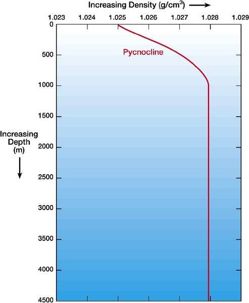

Why is that? I'm pretty sure water at 4deg is at the most dense point so I would say it is denser than on higher levels when temperature rises.
Well, I said "don't change that much", which means it still does change a little. It probably changes around 0.01 g/cm3 comparing sea level and the bottom of the ocean, if not, less. Density of sea water is around 1.025 - 1.027 at sea level. So a 1% difference (or less) is a minor difference to me.
Likes MulderFBI
You are right the difference is not that big:
"This is a simple density-depth ocean water profile. You can see density increases with increasing depth. The pycnocline are layers of water where the water density changes rapidly with depth. This density-depth profile is typical of what you might expect to find at a latitude of 30-40 degrees south.
Windows to the Universe original image"
