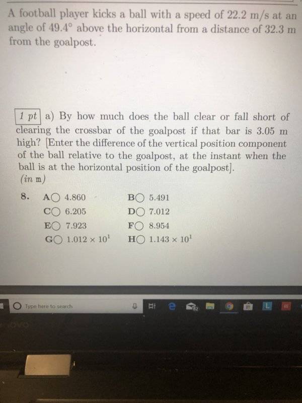

Please help, I am thoroughly stumped trying to solve this kinematics question on my study guide. I’ve tried everything I know of but cannot get an answer that’s even an option.
R = v^2sin(2theta)/g
v^2 = vi^2 -2gd
x = vcos(theta)t
Likes Delta2

You could solve that equation for the time it takes to reach the horizontal position of the goal post.
It seems to me that you have forgotten to write down the equation for the vertical position of a ballistic object as a function of time.

Hello Josh.
How are you going to solve this problem without the equation for vertical position as a function of time? If you can figure out the elapsed time when the football is at the required height (3.05 m.) I think you can you then solve the rest of the problem.

according to me the answer should be "G". Use equation of trajectory and put x=32.3 v=22.2 and theta=49.4 after plugging in the values you should get some "y" after that just subtract the height of the goal post.
If significant figures are to be taken into account, none of the answers are correct.
