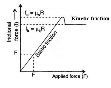

Are there any instances where kinetic coefficient of friction greater than static coefficient of friction? Is this possible in nature?

Net force in a particular direction should be higher than maximum static friction between the surfaces for motion to take place in that particular direction. I am more confused than before.
From Live Science
Friction also acts in stationary objects. Static friction prevents objects from moving and is generally higher than the frictional force experienced by the same two objects when they are moving relative to each other. Static friction is what keeps a box on an incline from sliding to the bottom.

What if the applied force is greater than the static friction but less than the kinetic friction?
I think the object will start to move with an acceleration and after that the kinetic frictional force will balance the applied force and object will have 0 acceleration and no change in previous motion and will continue to move with constant velocity.
Here is a thought experiment inspired by post #2 by @PeroK. Put a block of mass ##m## on a horizontal piece of plywood. Lift one edge of the plywood veeery slowly to create an increasing angle ##\theta## with the horizontal. There will be a critical angle ##\theta_c## at which the force of static friction reaches its maximum value ##f_s^{max}=\mu_s~N=\mu_s~mg\cos\theta_c##. The component of gravity down the incline is ##F_x=mg\sin\theta_c##. Setting the two equal just before the block starts sliding, gives the condition,$$\mu_s mg \cos\theta_c=mg \sin\theta_c.$$ At that point the block is not sliding yet. Now increase the angle by a very small amount ##\delta\theta## beyond ##\theta_c##. The maximum static friction, ##f_x^{max}## remains the same. The component of gravity along the incline becomes, to first order, $$F_x=mg\sin(\theta_c+\delta\theta)\approx mg(\sin\theta_c+\delta\theta)=\mu_s mg \cos\theta_c+mg(\delta\theta)=f_s^{max}+mg(\delta\theta)$$ At this point the block starts sliding because, clearly, ##F_x>f_s^{max}##. At this point the normal force is, to first order, unchanged,$$N=mg\cos(\theta_c+\delta\theta)\approx mg\cos\theta_c.$$Because the block is now sliding, the force of friction opposing gravity is $$f_k=\mu_kN=\mu_k mg\cos\theta_c.$$For the block to keep on sliding, $$f_k \leq F_x \rightarrow~\mu_k mg\cos\theta_c \leq \mu_s mg \cos\theta_c+mg(\delta\theta) $$which results in$$(\mu_k -\mu_s)\cos\theta_c \leq \delta\theta .$$The inequality is certainly satisfied if ##\mu_k <\mu_s## because ##\delta\theta## is positive. If ##\mu_k >\mu_s## note that ##\delta\theta## can be made arbitrarily small and in the limit ##\delta\theta \rightarrow 0##, ##\mu_k =\mu_s##. When you have equality, it means that the block slides with constant velocity right at the critical angle for the maximum value of static friction and I see no reason why that cannot be so. However, as you can see by the very definition of these coefficients of friction, it must be that $$\mu_k \leq \mu_s.$$

Isn't it maximum kinetic fraction So It will oppose the opposite force by matching its value like in static friction OR is it different for kinetic friction?
It's different. There is no maximum kinetic friction and according to the simplified model the kinetic friction is constant and given by ##f_k=\mu_k N## In real life kinetic friction is velocity-dependent and goes to zero when the velocity goes to zero,
Hmm. Static friction matches the applied force because if you got the maximum static friction, the object would move in the opposite direction to the applied force!
As @kuruman says kinetic friction is always at a maximum. Otherwise, if there were no applied force, there would be no kinetic friction. Kinetic friction acts on a body in motion, regardless of whether the body is subject to any other forces.
