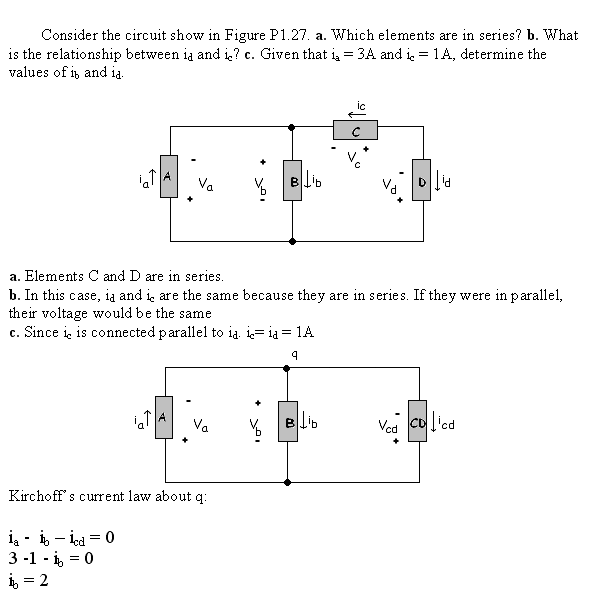

Kirchoffs current law. Someone check to make sure its correct?
In summary, according to the given conversation, due to the series configuration, Ic and Id are equal in magnitude but opposite in direction. If Ia is 3A and Ic is 1A, then Id is -1A. The equation Ia + Ic - Id - Ib = 0 is used to determine that Ia and Ib are equal in magnitude, resulting in Ia=Ib = 3A. Using the Node with Ia and Ic entering and Ib leaving and applying KCL, we can also determine that Ia+Ic=Ib or 3A + 1A =4A. Similarly, for the node with Ib and Id entering and Ia leaving, we can

In the picture.
Due to the series configuration, Ic and Id are equal in magnitude but opposite in direction.
if Ia = 3A, Ic = 1A, then Id = -1A
3A + 1A - 1A - Ib = 0
as a result, Ia=Ib = 3A
I agree with the Ic Id sign. However, Using the Node with Ia and Ic entering and Ib leaving and using KCL. I get Ia+Ic-Ib=0 therefore Ia+Ic=Ib or 3A + 1A =4A
You are right.
for the node with Ib and Id entering, Ia leaving
-Ia + Ib + Id = 0
-3 + Ib + -1 = 0
Ib =4A
