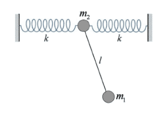

A particle of mass ##m_1## hangs from a rod of negligible mass and length ##l##, whose support point consists of another particle of mass ##m_2## that moves horizontally subject to two springs of constant ##k## each one. Find the equations of motion for this system.
##L=T-V##
What I first did was setting the reference system on the left corner. Then, I said that the position of the mass ##m_2## is ##x_2##. I also supposed that the pendulum makes an angle ##\theta## with respect to the vertical axis ##y##. So the generalized coordinates of the system would be ##x_2## and ##\theta##. Thus, the coordinates of ##m_1## are:
  • ##x_1=x_2+l\sin\theta##
  • ##y_1=-l\cos\theta##
Then I took the time derivative of both ##x_1## and ##y_1##:
  • ##\dot x_1=\dot x_2+l\dot\theta\cos\theta##
  • ##\dot y_1=l\dot\theta\sin\theta##
The Kinetic energy ##T## would be the sum of the kinetic energy of each mass ##T=T_1+T_2##. Since ##T1=\frac{1}{2}m_2\dotx_2^2## and ##T_2=\frac{1}{2}m_1(\dot x_1^2+\dot y_1^2##, I got:
  • ##T=\frac{1}{2}m_2\dot x_2^2+\frac{1}{2}m_1(\dot x_2^2+l^2\dot\theta^2+2\dot x_2\dot\theta l)##
Now, I have trouble with the potential energy. The potential energy of ##m_1## is easy, it would be just ##V_1=m_1gh##:
  • ##V_1=-m_1gl\cos\theta##
The potential energy of ##m_2## would be the sum of the potential energy that each spring has on the mass. What I did was saying that that the mass ##m_2## moves a distance ##x_2##, thus the lhs spring would have a displacement of ##x_2## and the rhs spring would have a contraction of ##x_2## likewise. So:
  • ##V_2=\frac{1}{2}k x_2^2+\frac{1}{2}k(-x_2)^2=kx_1^2##
But, according to my teacher, if the first spring moves a distance ##x_2##, then the second would contract a distance of ##a-x_2##, where ##a## is the distance between the walls, that is constant. I don't understand why this is the case, can you please explain it better for me to understand? Thanks.

I don't understand it either. If ##s_1## and ##s_2## are the lengths of both springs then ##a = s_1 + s_2##.
Now, if one spring stretches by ##x## then the other spring must be compressed by the same amount, ## (s_1 + x) + (s_2 - x) = a##
And if ##V_1 = \frac12 k x^2## then ##V_2 = \frac12 k x^2## and so ##V = V_1 + V_2 = k x^2##
Although, I have the origin where ##m_2## is at rest. You say your origin is in the left corner. So the left spring is attached to the origin. Your teacher attaches the the right spring to ##a##.
Now if you move ##m_2## the new location will be at ##x_2## as measured from the origin for the left spring, and at ##a - x_2## which is measured from the right wall for the right spring.

No. I count ##V_2=0## when ##x_2=a/2##, i.e. when the mass is halfway between the two walls.
So, the result I got would only be correct if the origin is halfway between the two walls?
Yes. And for your original coordinate see #2.

I'm I bit confused by the use of ##x_2##, so let's say that ##x_2## is the position of the mass at its equilibrium position, i.e. ##x_2=a/2## as you said. And let ##x## be the position of the mass at some time Then if the mass moves to the right to a point ##x##, the left spring would stretch a distance of ##x-x_2=x-a/2##. But, wouldn't the spring on the right be compressed by the same amount?
That's the reason why ##k## ,not ##\frac{k}{2}## for a single spring, in ##V_2##. Doubled as you did yourself in #1 and #3.
Likes Davidllerenav
Davidllerenav said:
Homework Statement:: A particle of mass ##m_1## hangs from a rod of negligible mass and length ##l##, whose support point consists of another particle of mass ##m_2## that moves horizontally subject to two springs of constant ##k## each one. Find the equations of motion for this system.
Relevant Equations:: ##L=T-V##
But, according to my teacher, if the first spring moves a distance ##x_2## , then the second would contract a distance of ##a-x_2##, where is the distance between the walls, that is constant. I don't understand why this is the case, can you please explain it better for me to understand?
Your generalized coordinates are relative to an origin that is at ##m_2## when the system is at equilibrium, string vertical, springs relaxed. This choice allows you to use the same symbol ##x_2## to denote both the generalized coordinate and the amount by which each spring is compressed or stretched. Thus, if ##m_2## is displaced to the right, the elastic potential energy is as you have written it ##V_{\text{el}}=\frac{1}{2}kx_2^2+\frac{1}{2}kx_2^2=kx_2^2.##
Now suppose you choose to measure generalized coordinate ##x_2## relative to the left wall. If ##m_2## is again displaced from equilibrium to the right, the amount by which the left spring is stretched is ##x_2-\frac{a}{2}## and the amount by which the right spring is compressed is ##\frac{a}{2}-x_2## and the potential energy is ##V_{\text{el}}=\frac{1}{2}k(x_2-\frac{a}{2})^2+\frac{1}{2}k(\frac{a}{2}-x_2)^2=k(x_2-\frac{a}{2})^2.##
In such problems involving springs and Lagrangians one needs to be careful to enunciate the differences, if any, between generalized coordinates and spring displacements.
