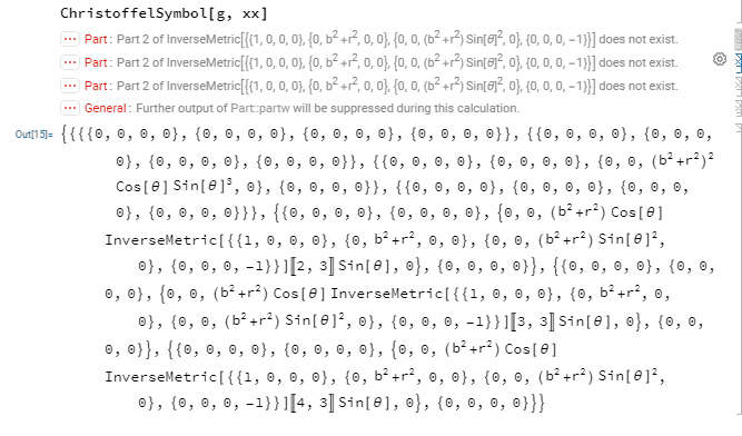

But I get
What am I missing? Besides, I'd like to learn how could I display the answer (once I know how to actually get it of course).
Any help is appreciated.
Thank you :smile:

What is InverseMetric?
Likes JD_PM
Oh I did not define the InverseMetric! Thanks for pointing it out.

I am struggling now in how to call out the specific Christoffel symbols correctly; I am trying
Code:
affine[[3,3,2]]
But I get zero instead of ##\cot(\theta)##; the same happens to me with other non-zero terms.
Likes Ishika_96_sparkles and JD_PM
OK I understand how to do it now! :smile: (more details)
My issue was in how to call out the function. Let's go step by step:
