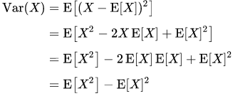

Qualitatively, the slope is the covariance / variance
[ n×Σx^2 - (Σx)^2 ] is the variance:
the covariance in the numerator is the same thing by XY instead of X2. If the correlation is perfect, covariance = variance and the slope is 1. If there is no correlation, then covariance is zero and so is the slope.
