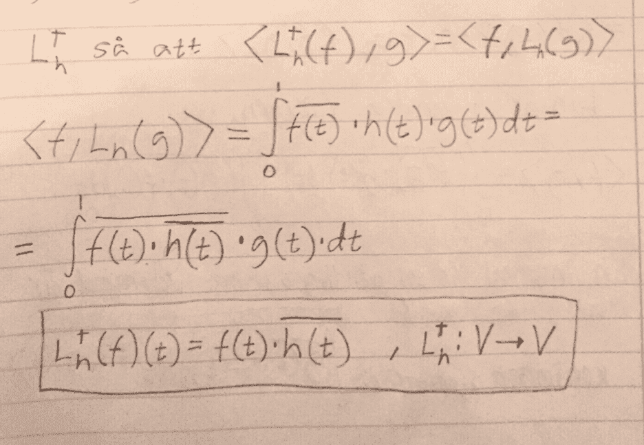

Let ##V = \mathbb{C}([0, 1], \mathbb{C})## be the vector space of continuous functions ##f: [0,1] \rightarrow \mathbb{C}## with inner product:
$$\langle f|g \rangle = \int_0^1 \overline {f(t)}g(t)\;\mathrm{d}t$$
For ##h \in V## , let ##L_h: V \rightarrow V## be the operator defined by ##L_h(f)(t)=h(t)f(t)##.
b) Determine the adjoint operator to ##L_h##
c) For which functions is the operator ##L_h## self adjoint?
d) For which functions is the operator ##L_h## unitary?
e) Give example of one function h(t) such that the operator ##L_h## is self adjoint and has at least two different eigenvalues
b)

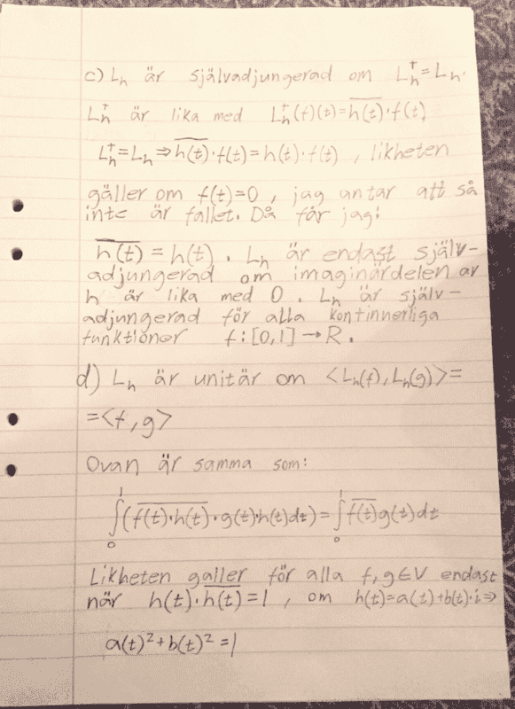

c and d):
In c) I say that ##L_h## is only self adjoint if the imaginary part of h is 0, is this correct?
e) Here I could only come up with eigenvalues when h is some constant say C, then C is an eigenvalue. But I' can't find two_Otherwise does b-d above look correct?

It's looks all right. For d) perhaps think about writing ##h(t)## in polar form - that might be neater.
For e), remember these functions are only continuous. You have lots of options for where they are zero and non-zero.

I was thinking ##e^{ia(t)}## for some real function ##a(t)##. But, what you have is fine.
Try thinking about continuous functions more generally. Something like ##\cos t## is no good. That would never work. What's "normal"?

What about a continuous step-function?
Ooh, right! You mean if I for example said h(t)=1 in the intervall 0<t<0.5 and h(t)=2 in the intervall 0.5<t<1. One eigenvector for the eigenvalue 1 could be the function f(t) which is ##t-0.5## on the intervall 0<t<0.5 and f(t)=0 on 0.5<t<1 ? And for for the eigenvalue 2 an eigenvector could be g(t) = 0 on 0<t<0.5 and ##g(t) =t-0.5## on 0.5<t<1?
That's not a continuous step function. You need to join the steps. The eigenfunctions would be any function that is zero outside one of the steps.
Yeah, I realized that afterwards. So i can choose h = 1 on 0 <= t <= 1/3 and h=3t on 1/3 < t < 2/3 and h=2 on 2/3 <=t <= 1. An eigenvector to eigenvalue 1 could be a function that is t-1/3 on the intervall 0<=t<=1/3 and 0 on 1/3<t<=1. An eigenvector to eigenvalue 2 could be a function that is 0 on the interval 0<=t<2/3 and t-2/3 on 2/3<=t<=1. Is this correct?
Likes PeroK
Yes. Note that you have a whole eigenspace of functions that are zero on one of these regions. The set of functions that are zero on ##[0, 2/3]## is a vector subspace - and is the eigenspace of your operator corresponding to eigenvalue ##2##.
