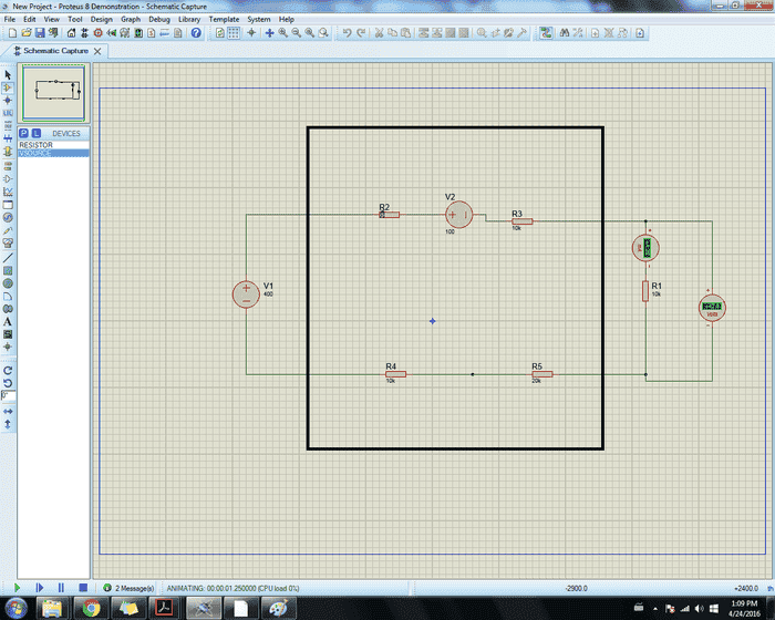

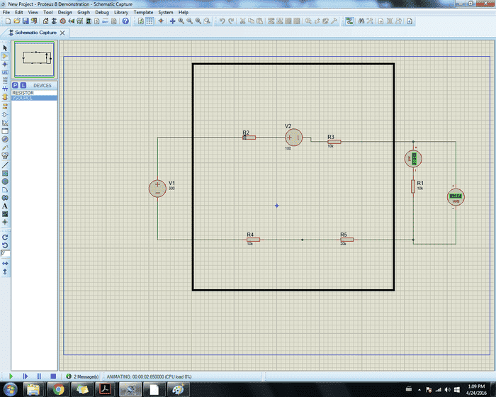

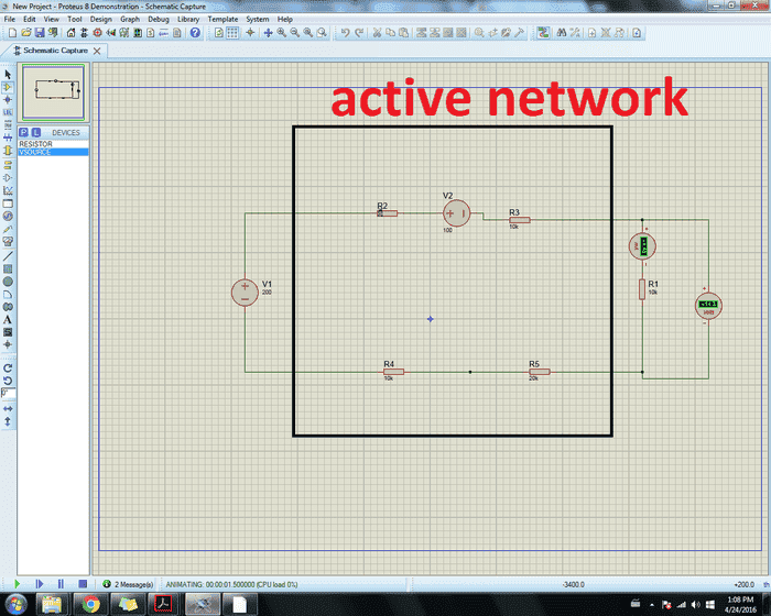

For example look at those simulations, imagine this network in the black box is the active network and you don't know what is in it ( active since it has active sources, if there were only resistors equation would have y = 0)
capture
Let the V1 be excertation and the voltage measured by the voltmeter be response V2 .
So for the first two pictures we have
V1 = 200 V , V2 = 14.3 V
V1 = 300 V , V2 = 28.6 V
V2 = xV1 + y , and solving this equation you get
x = 0.142 and y = -14
Now suppose you wanted to find the voltage for V1 = 400 V
you already know constants so it's
V2 = V1*0.142 -14 = 400 * 0.142 -14 = 42. 8 V .
Look at the picture below , we get 42.8 V the same result.
screen shot on windows
That is the whole idea about this theorem as I said if there were only resistors in the black box we would have constant y = 0 , so equation would look like V2 = x*V1 ,linear homonogeous equation.

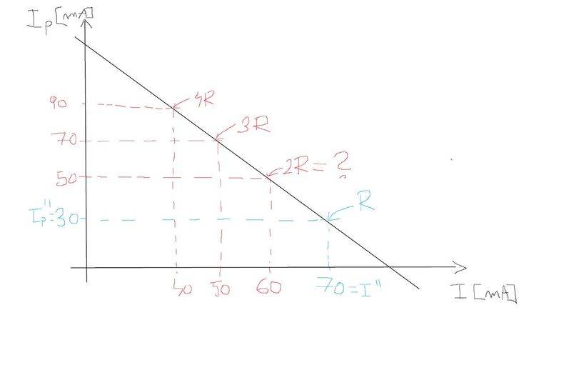

Try writing Ip in terms of that switched resistance (I'll denote it R* for convenience, i.e.,
Ip = kR* + y
If you need to find I'' then determine I as a similar linear relationship to R*.
Likes cnh1995 and Ivan Antunovic
Ip = kR* + y
70 m = x30 +y
90 m = x40 +y
x = 0.002 , y = 0.01
Ip" = xR + y = 0.002 * 10 + 0.001 = 30mA , may I ask you how did you come up with this?
I was thinking it could be since R becomes excitation and by compensation theorem
http://www.electrical4u.com/compensation-theorem/
if a current or voltage is known on the resistor it can be replaced by ideal voltage/current source and vice versa
Likes cnh1995
The only independent variable (called "input") in this system is the switch position, i.e., the resistance R. So it seemed that you should be looking for the linear relationship between output Ip and input R*.
