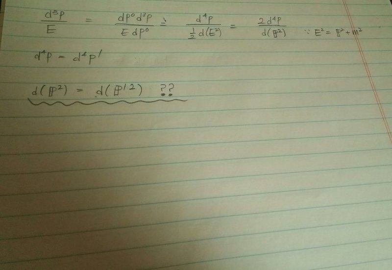

Hi
I'm studying electron-muon scattering
and now considering the Lorentz invariant integration measure.
The textbook introduced it, which use dirac delta function to show that d3p/E is a Lorentz scalar.
I understood it but I wanted to find other way and tried like this:
I need a hint on the underlined equation. The primed one is lorentz transformed one.
How can I show that d(p^2) is Lorentz invariant?
Just calculate it hard ?
Your attempt has a mistake because ##E## is not the same as ##p^0##. The four variables ##p^0,p^1,p^2,p^3\equiv (p^0,{\bf p})## are 4 independent variables, but ##E=\sqrt{{\bf p}^2+m^2}## is not independent of ##{\bf p}##. Hence, your conclusion that ##d{\bf p}^2## should be Lorentz invariant is wrong.
The measures ##d^4p=dp^0 d^3p## and ##\frac{d^3p}{E}## are Lorentz invariant, but ##dE d^3p## and ##\frac{d^3p}{p^0}## are not.
If you are still confused, try first to solve the following problem. Consider 3-dimensional Euclidean space with Cartesian coordinates ##x,y,z##. In this space, consider the sphere defined by ##x^2+y^2+z^2=R^2##, which is a 2-dimensional object invariant under 3-dimensional rotations. Find the measure of area ##dA## on the upper half of the sphere, in the form ##dA=f(x,y)dxdy##. Argue that this measure is rotation-invariant simply because the sphere is rotation-invariant. Find ##f(x,y)## explicitly in two ways: (i) geometrically and (ii) by starting from volume element ##dV=dxdydz## and using a ##\delta##-function trick. Can you see the relation with the problem of Lorentz-invariant measure above? In particular, can you see the analogy between ##R## and ##m##?
Partial solution: You should get $$f(x,y)=\frac{R}{\sqrt{R^2-x^2-y^2}}.$$Is it correct to write the right-hand side as ##R/z##?

vanhees71 said:
Isn't this a bit too complicated?
Yes, but he already indicated that he understands the standard proof of Lorentz invariance with the use of a delta function. He wanted a more direct proof without a delta function, and in his attempt he failed. I wanted to explain him what exactly was wrong with his attempt. In addition, I also thought that it would be easier to undertstand this in a case which can be more easily visualized, i.e. where 4-dimensional Lorentz invariance is replaced with 3-dimensional rotational invariance. While the calculation turned out to be longer, I thought that the resulting geometric idea would be easier to understand intuitively.
Likes vanhees71
Demystifier said:
Your attempt has a mistake because E is not the same as ##p^0##. The four variables ## p^0,p^1,p^2,p^3\equiv (p^0,{\bf p}) ## are 4 independent variables, but ##E=\sqrt{{\bf p}^2+m^2}## is not independent of p.
I don't understand this part.
1) The 4-momentum is always defined to be ## p^\mu=(E,\bf p) ## in a particular frame. Now you say ## p^0 ## is not the same as E. So what is it?
2) You say that different components of the 4-momentum are independent but what about the restriction ## p^2=-m^2 ## on any 4-momentum?
Since ##E## is defined as ##\sqrt{{\bf p}^2+m^2}##, these two questions are really the same. To answer them, it should be enough to give one example where ##p^{\mu}## is not equal to ##(E,\bf p)##. So here is one example: the 4-momentum integration in a Feynman diagram with a loop.
If you are still confused, think about doing the exercise proposed in #2.
I think I understand it now. It seems that the right way of thinking about 4-momentums is that there is a 4-dimensional momentum space and particles move on ## p^2=-m^2 ## hypersurfaces in this space. I was missing this viewpoint. thanks.
