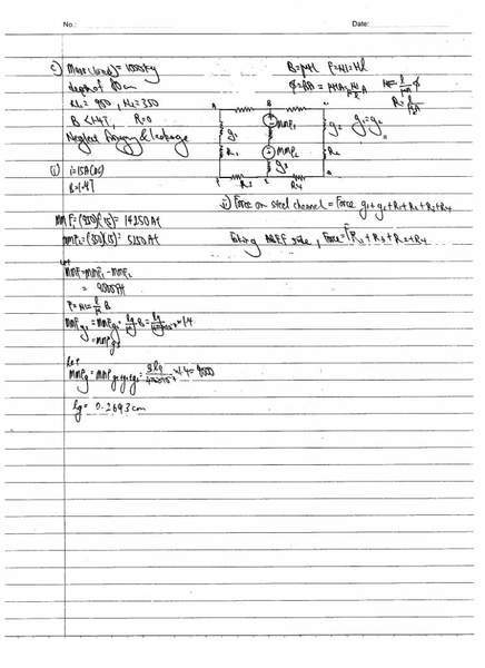

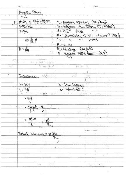

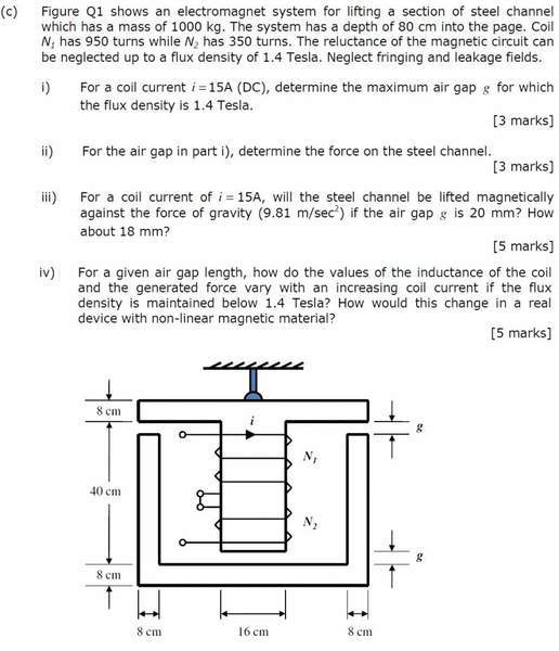

Refer attachment q.
Refer attachment f.
Refer attachment t.
Please help, this lecturer likes to give questions that are not taught during exams.
