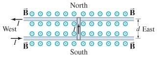

Suppose the rod in the figure has mass m= 0.40kg and length 20cm and the current through it is I= 40A .
(Intro 1 figure)
If the coefficient of static friction is us= 0.55, determine the minimum magnetic field (not necessarily vertical) that will just cause the rod to slide. Give the magnitude of B.

I'd start by drawing a free body diagram for the rod. You'll need to think of all the forces that act on the rod.

More hints: they have given us the mass and the friction coefficient. What forces would arise from that information?
The only equation I have with I:
F = ILB sin (theta)
But they are 90 degrees from one another so wouldn't it be Fmax = ILB
Good, that's the right equation. And yes, θ=90o here.

I understand how to do free force diagram..I just don't understand how this one is supposed to be...is the fn force coming from the other rod?? When it talks about the rod sliding...what is it sliding on?
The rod is sliding along two rails, oriented East-West as shown in the figure you posted. That is where the friction comes from.

You're method would be correct if B were vertical and that magnetic force FB were horizontal.
Since the problem statement said B is not necessarily vertical, then FB need not be horizontal. FB can have a vertical component, which enters into the expression for FN:
FN + FB-vertical = mg

It sounds like you have not yet drawn a correct free-body diagram to help visualize what is going on. Here is one showing two of the four forces involved, as well as the direction of B:
Side view, showing the rod viewed end-on​
If you add mg and FN to the figure (both are vertical forces), you can then set the net force in the vertical and horizontal directions equal to zero, and go from there.
