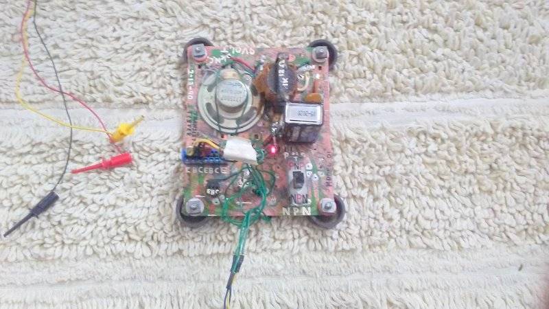

This tester has been in use for 28 years no problem yet. Made out of left overs.

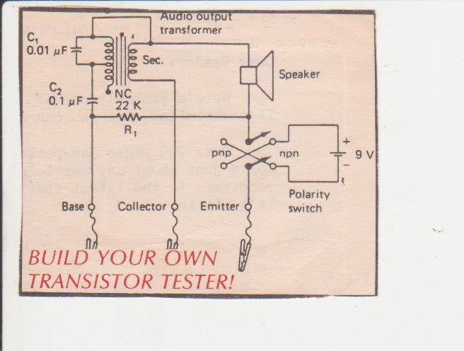

Cool, do you have the schematic?

Really useful when you have a couple thousand transistors with unclear operation status
