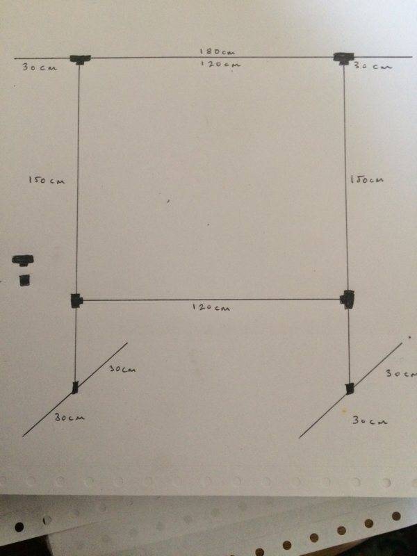

Hello everybody,
I am planning to make a gong stand using tube clamps and aluminium tubing, but I am unsure whether the tubing will be strong enough. I like the idea of using aluminium, to aid with portability of the stand. As the stand will be used to play the gong itself, which will move back and forth slightly and resonate, I imagine this is quite a difficult calculation to carry out. As the gong cost over £2000, I really do not want to drop this beautiful and expensive instrument. So thought I would ask for some advice.
The gong is 38" in diameter and weighs 15kgs.
The aluminium tubing I had in mind has an external diameter of 33mm and an internal wall of 3mm. It is an aluminium alloy (6082).
This is a rough plan for the stand...
245660
Apologies if my writing is a little tiny and unclear. The top bar is 180cm, it overhangs 30cm on each side. So, the internal width is 120cm, height is 150cm, feet are 60cm. I will be using long tee tube clamps to fit it together. The clamps and tube are designed to be used for hand railing systems.
I could use aluminium with a thicker diameter and wall. I could also use steel. But, as the gong is already 15kgs, I would like to keep the weight down on the stand for easier transportation.
If anybody has any advice, it would be really helpful,
Philip

The gong only weighs 15kg. The Aluminum tubing you are using is certainly strong enough to support the gong. (Remember that airplanes are made from aluminum although the aircraft alloy, 7075T6 is stronger than what you are using, it's not THAT much stronger. (It's also brittle and unweldable so probably not a good choice here.) Why are you looking at 6082 Aluminum alloy? If you are going to use aluminum, use 6061T6. It's a lot more common and comes in just about any form you want and it's easy to work with. The fact that you didn't see it on the list of alloys you mentioned suggests using a more common alloy. It's also probably cheaper.
However, if it were me, I would simply use some steel tubing to ensure I had a nice solid base of support that is also nice and rigid. Assuming the gong frame is not going to sit in the same place forever and will be transported here and there for use, you should consider that it sholfd hold up to abuse from unknown forces due to throwing the frame in a truck and piling stuff on top of it. Sure, aluminum is lighter (about a factor of 3), but you aren't talking about a whole lot of material. Personally, I can't see that the aluminum will be any problem at all in supporting 30lbs of weight and a mallet strike, but if you think that the safety of your gong comes down to having to calculate anything, it's not worth cutting it close when you could just as easily use steel and not worry about anything.

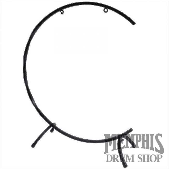

Spinnor said:
Only $364.
https://memphisdrumshop.com/paiste-floor-gong-stand-for-38-c-type-st48138
Less expensive @ https://www.google.com/search?tbm=s......1ac.1.34.products-cc..16.7.333.psGEaX_xJS8
There are a lot of drawbacks to doing it yourself. If you are doing it for fun or your design fits special needs that is one thing but if your time is valuable and you want something that is of a proven design...
Also aluminum tubing is not inexpensive.

that is a good observation: the aluminum is so light compared to steel that it could tip over or slide if you hit the gong with a heavy strike. Also, aluminum is far less rigid than steel, causing unwanted deflections and vibrations. Might work, might not.
As long as the base is made wide enough the weight of the frame does not matter, it could be massless. The weight of the gong itself gives stability to the system of gong and frame. Tipping force is a function of total weight of the frame and gong and of the width of the base.
Does the quality of the sound depend upon the dynamics of the stand?? If so the materials choice is much more interesting...
If possible, for strength there should be triangulation somehow at every corner, particularly on the base.
Why is there a one ft overhang at each end he top bar?

Need to triangulate stand so it doesn't parallelogram and collapse laterally. Also triangulate at least one side of feet so it doesn't collapse fore & aft. Probably triangle on back side so less of tripping hazard. Sure there's some triangulation in lugs holding tubing together, but it's very small. You want triangles with sides of about 1/2 length of each tube.
To allow for gong's movement, you can curve triangle's centre away from stand's axis.
Tubing diameter is used for rigidity since stiffness goes up by 4th-power of diameter. So 25mm tubing with at least 1mm thickness should do. Avoid thinner than 50:1 ratio diameter to wall-thickness as that's when crumpling sets in.

The stand would work initially (the static load will be actually well supported even by D=25mm & t=1.2mm tubes), but it have bad longevity - forces of beating gong would be highly leveraged at tee clamps, eventually deforming them and making entire stand wobble and tilt.
If you use this design, use only steel tee clamps with longest possible sleeves to reduce leverage. Zinc casts and especially plastic clamps are out of question.
Also, it is better to have set screws in the upper and middle clamps - these 4 clamps would have torques resulting in much fretting and damage after beating gong if set screws are not used.
