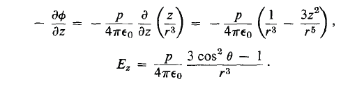

Hi All,
I need mathematical help from the topic electrical potential for lectures on physics by Richard Feynman.
Need some help to understand mathematical method used here.
question :
( how this partial differential of ( -p/4∏ε (z/r^3)) with respect to z
⇔ -p/4∏ε (1/r^3 - 3z^2 / r^5) ?
similarly how to do partial differentiation with respect to x
( how this E = p/4∏ε * 3z/r^5 √(x^2 + y^2) ⇔ p/4∏ε * (3 cosθsinθ/r^3)
Please look for attachments
  • electrical potential.pdf

you use both the product rule (or the quotient rule) and the chain rule
for the chain rule, use ∂/∂z (f(r)) = ∂f(r)/dr ∂r/∂z
(and ∂r/∂z = … ? :smile:)

Thank you tiny-tim,
after doing partial differentiation and chain rule i got following.
d (z/r^3)/dz = 1/[r][/3] - 3z/[x^4] * dr/dz
but actual answer is 1/[r^3] - 3z^2/[x^5]
And what is the definition of 'r' in terms of x, y, and z?

yes Tiny-tim,
actual answer is
[itex]\frac{\partial (z/r^3)}{\partial z } = \frac{1}{r^3} - \frac{3z^2}{r^5} [/itex]tiny-tim, as you told me i did partial differentiation using quotient rule and chain rule
and i got
[itex]\frac{\partial (z/r^3)}{\partial z } = 1/(r^3) - (3z)/r^4 \frac{\partial r}{\partial z} [/itex]where
[itex]
r = √(x^2 + y^2 + z^2)
[/itex]
and i got
yes, but what is ∂r/∂z ?
(you can't just leave it there like that! :rolleyes:)
I don't know ! :confused:
what is [itex]\frac{\partial r}{\partial z}[/itex]
I did following :
[itex] \frac {\partial \frac {z}{r^3}}{\partial z} = \frac {1 * r^3 - z * \frac {\partial r^3}{\partial z}}{(r^3)^2}[/itex]
= [itex] \frac {1}{r^3} - \frac {z \frac {(\partial r^3)}{\partial z}}{r^6} [/itex]
where
[itex] \frac {\partial r^3 }{\partial z} = (\frac {\partial r^3 }{\partial z}) (\frac {\partial r}{\partial z}) [/itex]
=> [itex] 3 * r^2 * \frac {\partial r}{\partial z} [/itex]
putting back I got
=> [itex] \frac {1}{r^3} - \frac {3z}{r^4} * \frac {\partial r}{\partial z} [/itex]
Let me know if i am doing wrong.. thanks in advance

… so what is ∂r/∂z ? :smile:
Think of r as f(x,y,z) = (x^2+y^2+z^2)^(1/2)
What is ∂f/∂z?
