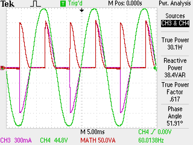

Hi guys,
For a science experiment I've got to measure the power consumption of my circuit of a 100W incandescent light bulb connected to the mains AC, with a dimmer switch to vary its brightness. I was planning on just using one of those plug-in energy monitors with a digital display but I've heard that when there is a dimmer in the circuit (triac) this would make the readings of these plug-in energy monitors completely wrong - errors up to 50% - is this true? If so how else can I easily measure the power consumption of such a circuit?
Thanks

You haven't said, but I'm assuming you live in a country where the mains voltage is 230 VAC.
What equipment do you have available for making measurements at your school? Do you have voltmeters, ammeters, oscilloscopes, resistors, capacitors, small transformers, etc.?l
Do you understand how dimmers work (by narrowing the waveform of the applied voltsge)?
I suspect that the circumstance where the error of your energy monitor becomes high is where the light is greatly dimmed, and the applied voltage becomes a very narrow pulse.
What accuracy will be acceptable for your project? Will reduced accuracy be acceptable at the highly dimmed range of the dimmer?

I see a couple of problems with this. First you end up with a value proportional to the average (absolute, if full wave rectified, preferably) value of the AC current, when what is needed is the RMS value. Then how does this value for the current become a value for power? Isn't a multiplication by some voltage needed? We don't want to display the current; we want to display power.

Dimmers are often based on varying the conduction angle of thyristors or SCRs, and result in current curves that are non-sinusoidal (and often create an appreciable amount of RFI for the cheaper versions). This will complicate power calculations.

The load voltage and current aren't sine waves, which I thought you understood, since you said "Reducing the duty cycle of the load by chopping the ac voltage...".
Also, the OP said "...there is a dimmer in the circuit (triac)..."

Obtaining load power would still require squaring the current, if we knew the load resistance.
But, since the load is an incandescent light bulb, the resistance of the bulb is not a constant; it depends on the amount of dimming. Just squaring the current won't work when the load resistance isn't known.

You apparently don't understand how a triac light dimmer works. The on-off period is not on the order of seconds. How would that be called a "dimmer"? The light would be on full brightness for a few seconds and then completely off for a few seconds.
A triac light dimmer is a phase controlled device. The 50/60 Hz mains waveform is turned on to the load partway through every half cycle, so the on-off period is every 100/120th of a second.
Here's a scope capture showing mains voltage (green), load current (purple) and instantaneous power (dark red) with about half power applied to a 60W incandescent bulb:
