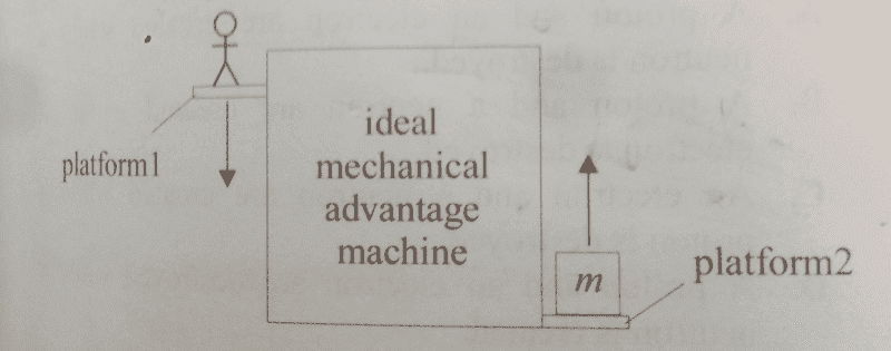

The question is as follows: A man of mass 100kg is placed onto platform 1. The maximum weight that he can lift using this machine is twice his own weight (200kg*g). The mechanical advantage of the machine is constant.
If the mass of the object is 100kg, 1) what is the force upward felt on the engineer and mass respecitvely
and 2) What is their accelerations?

So this is where i get stuck, and the book I'm using says that Fnormal(mass) = 2*Fnormal(man) due to the mechanical advantage. But I thought mechanical advantage was in regards to force applied vs force out (so the weight of the man vs the normal force applied to the mass?).
If you do plug accordingly in you get the right answer:
2*(2Fnormal(man)) + Fnormal(man) = 300g
5Fnormal(man) = 300g
Fnormal(man) = 60g = 600 N
Fnormal(mass = 1200N
WOW that was long. So thanks for bearing with me. that's the correct answer, but what confuses me is that how can that ^ be the normal force when the normal force for the mass when its supposed to be double the input force? Which in this case would be 100kg*g (the weight of the man)?

The mechanical advantage is the force amplification factor when using a tool.
If the mechanical advantage is A, then ##F_{out} = AF_{in}## ... with appropriate choices for input and output forces.
For your problem, A=2 is when the LHS is the input and A=0.5 when the RHS is the input.
LHS=input (the weight of the man) is what your book did.
Working the acceleration involves figuring the free-body diagrams for each side separately.
I wouldn't worry about "normal force" etc and just work the physics.
If the weight of the man is W, then the mass of the man is W/g and the the LHS fbd gives ##W-mg/2 = Wa_{lhs}/g## or something right?

The man applies the normal force N1 on the platform, and it is doubled at the output, as normal force, applied to the load: N2=2N1. Imagine that he does not stand on the platform, but pushes it down with a force equal to his weight and normal to the platform - the result would be the same on the load. The normal forces are the input and the output.
m1g is the force of gravity exerted on the man. He also experiences the normal force from the platform, so the whole force acting on the man is m1g-N1, downward.
On the same way, the load experiences N2 -m2g upward force. And as you said, the work of the machine is the same on both sides, so a2=a1/2.ehild
