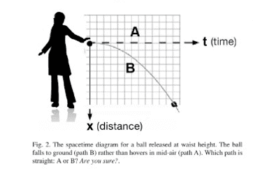

Unfortunately the article isn't open access, but in it he says, "
D. Warped time causes the ball to fall
At first glance, the distortion of time seems just as insignificant as the distortion of distance. The scale of time (scalet) varies by the factor:
scalet = (1- ((2MG/R2c2)x)1/2
between waist-height and floor level, again a change of only 1 part in 10-16.This tiny variation with height is much too small for our senses to detect, although it has been measured using atomic clocks,6 providing direct proof of Einstein's claim that the scale of time varies with location.
Why does this minuscule warping of time influence the ball's trajectory so dramatically? The reason is that even a small interval of time corresponds t o a large distance. When time is measured in meters. Imagine redrawing Fig. 2 with the time ax.is in meters rather than seconds. The half-second it takes the ball to fall corresponds to about 150 x 106m, so if both axes were drawn at the same scale, the spacetime diagram would stretch halfway to the Moon! Then we would see that the ball's trajectory in spacetime is very nearly a straight line. The distortion of time is indeed tiny. Yes, the ball falls I m to the floor. but it has to travel through 150 x I 06 m of time to get there!
We conclude that the distortion of time-not space causes a ball to fall. In essence, an object is deflected towards the region in which time flows more slowly. In this way, the invisible dimension of time makes its presence palpable in our three-dimensional world.
The bolded italicized statement is what I'm trying to understand. Why are objects deflected towards regions in which time flows more slowly? Especially since geodesics tend to prefer areas where time flows faster? Maybe it's unrelated.
It gets thrown out a lot, objects are deflected towards regions in which time flows more slowly. So I was trying to understand the math behind it? I think this goes back to the 4-velocity statement I made in the beginning. The magnitude of an objects four velocity vector must stay constant. If the temporal component changes, the spatial component must change to compensate. I'm not asking why the universe has deemed it so, just wondering what the math is.
So when an object encounters uneven time gradients, the temporal component of the four velocity changes, and its spatial component must compensate (more motion through space, less through time). And then you get the deflection towards the massive body. Unless this is completely wrong, this is how I'm viewing it?
First a misstatement in what comes before needs to be corrected. The ball's trajectory in spacetime is not "nearly" a straight line. It is exactly a straight line. It is a geodesic, and that's what a geodesic is.
With that understood, the word "deflected" in the italicized statement is also misleading. It is not that the object gets "deflected". It's that spacetime is curved. The object is following a straight trajectory through curved spacetime.
With that understood, the word "deflected" in the italicized statement is also misleading. It is not that the object gets "deflected". It's that spacetime is curved. The object is following a straight trajectory through curved spacetime.This is not a good way to view it, because the components are frame dependent. Actual physics is never frame dependent; the laws are the same in all frames.
Regarding the misstatement, that's not what it says, he says an objects trajectory in just the temporal portion is nearly a straight line. Referencing Figure 2 (which you obviously can't see), he says if it was drawn to actual scale, and written in meters rather than seconds, it would extend halfway to the moon. Figure 2 was just a flat spacetime diagram with two axes, t and x. A nearly straight line. He lays out that the change of only 1 part in 10 to the negative 16. So a line that is halfway to the moon, with a change of only 1 part in 10-16. Pretty sure that is nearly a "straight line" but not a straight line (speaking in Euclidian terms).
