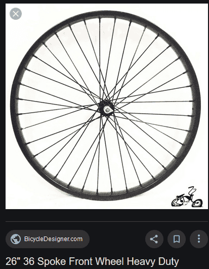

I guess I was thinking more of cases like my mountain bike (MTB), which has small disk brakes front and rear. In that configuration, the stopping torque on the rim is transferred from the hub to the rim/tire via the spokes. I haven't seen any big difference in the lacing of bicycle wheels with disk brakes versus rim brakes, but maybe there is some subtle difference?
From my understanding a rim brake does not give a torsional load on the spokes as a hub brake does. The lacing doesn't differ because it is no reason for using radial spoking that is weaker for both lateral and torsional loads.

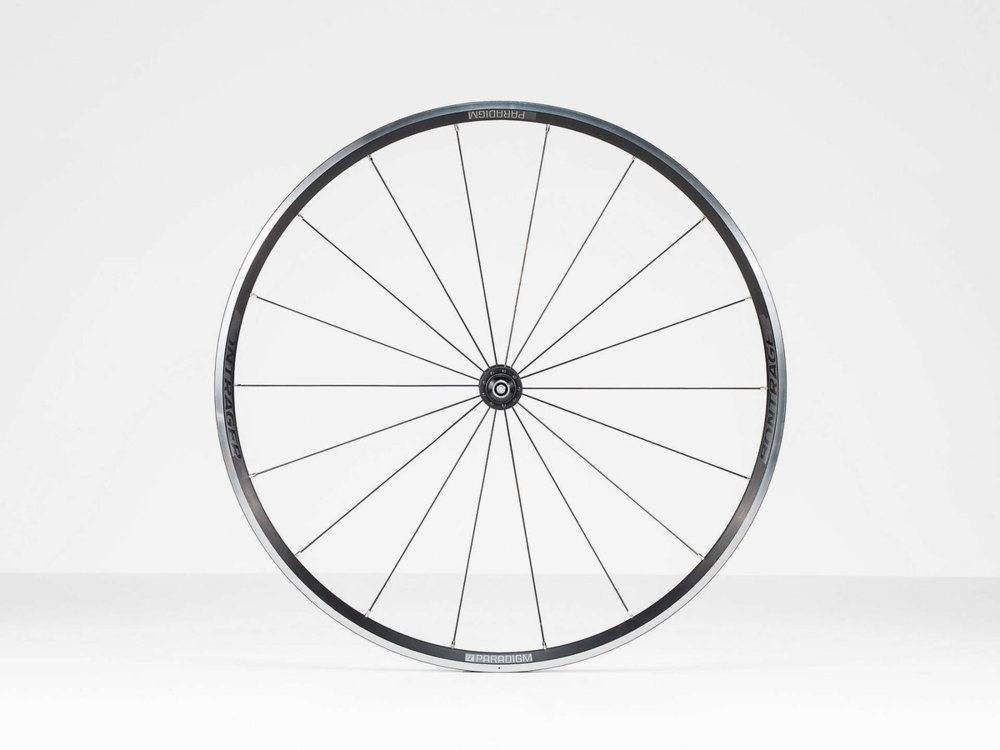

Often on high end front wheels with rim brakes, the spoke lacing is much less than that of a disk brake equipped front wheel.
