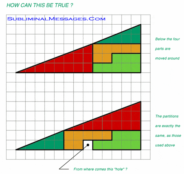

Ok, I've just signed up to this forum and i see there are a lot of very smart people and i just wondered if anyone knows the answer to the mensa triangle problem. I've sat and stared at it for hours and still i have no answer. Any theories.

Bottom line: Look at the slopes, one of the shapes isn't even a real triangle.
For example, the second triangle's green part has a steeper slope than the red part.
EDIT: The green triangle slopes don't equal the red triangle slope.
EDIT2: To see this, line up a ruler to the first triangle, connect the bottom left to the top right. Notice how the actual "triangle" is slightly below this. Do the same to the second one, and you will see the "triangle" is slightly bent upwards. So the change in that area is that extra square.
Damn you make it all sound easy but i see what you mean. I've just been counting the number of squares per triangle. Thats where I've been going wrong. Cheers
Oh, that thing! Check the slopes of the hypotenuse of the red right triangle: it has base 8 and height 3; slope 3/8. Now check the slope on the green right triangle: it has base 5 and height 2; slope 2/5. Since those are not the same, that "hypotenuse" of the entire "triangle" is NOT a straight line and it isn't really a triangle at all.
