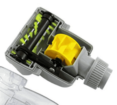

Check junkshops for vacuum sweeper "Turbo" accessories.
Many have a small plastic turbine inside to drive the brush..
I don't know if they'll withstand 212 degF , but it'd be easy enough to find out.
