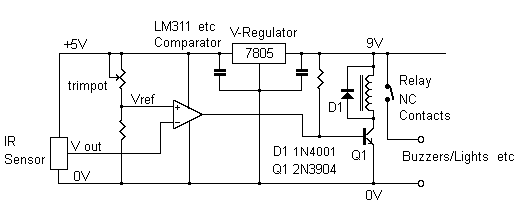

I use paintbrush in windows to draw circuits save them as a GIF file then up load them to various forums etc
here's a drawing I did for another person within the last few weeks
it will give you the basics on where to start
the trimpot can be used to adj the sensitivity
Using the NC ( Normally Closed ) contacts of a relay means they will be open whilst the relay is energised as the circuit gets an IR beam into the sensor.
When the beam breaks the relay will de-energise and the contacts will close and whatever alarm / lights you have in the relay circuit will get voltage via the relay contacts and operate
cheers
Dave
Now if you wanted the alarm bells / buzzer / lights to run off higher voltage then a minor mod to the relay contacts wiring would cater for that :)

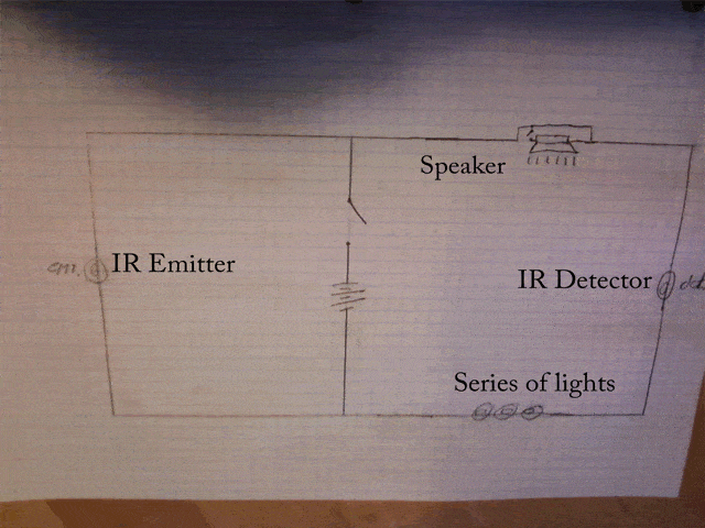

I'm sorry, I'm kind of confused. I tried to find a way I could draw out the circuit but I couldn't find an easy way it always looked really weird. I'm sorry! Is there any other way I could help explain?
ok no probs :)
draw it out neatly on paper and take a sharp/clear photo of it with your phone camera etc :) let us know when you have done that and we can talk you through uploading the pic
do you know how to resize a pic on your pc ? off the phone it will be huge 1000 or so pixels x 1000 or so pixels you want to get that down to 640 x 480 or similar size
Dave

There is my drawing sorry if it is not very clear I can try to explain things there if you need.
thats a good clear drawing well done :)
unfortunately tho making a system work isn't quite as easy as that
it does need something along the lines of the circuit I showed you in my other post
Do you have the electronics background for building a circuit like I showed you ?

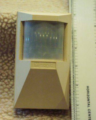

I think a better approach would be to use a passive infrared sensor (PIR sensor).
Apparent motion is detected when an infrared source with one temperature, such as a human, passes in front of an infrared source with another temperature, such as a wall.
These are typical of intruder alarm systems:

Hoogaloo said:
I think that would be kind of cheating because those things are already their own circuit. For this I was going to use something like this:
http://www.radioshack.com/product/index.jsp?productId=2049723
http://rsk.imageg.net/graphics/product_images/pRS1C-2110714w345.jpg
Okay. Then:
