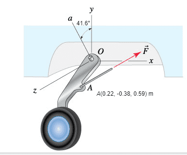

I'm a bit confused on when a force creates a moment about a point, and when it does not. In particular, in the attached diagram, would F be able to produce a moment about point A? I initially thought that wouldn't be possible as A lies on the same line as F, but since F does not seem to pass directly through A, I'm not so sure.

The force, F, alone does not produce torque at A. The fact that there is an offset stationary pivot point, O, means that there is a force at O opposing F which produces a torque around A. (You can see that if the pivot point, O was moved to the other side of the force at A, then the torque would switch to the opposite sign. So it is the opposing force at O that is controlling the torque.)
Note that the line of action of F does pass through A. A is the point or hole where the rod meets the bar. 3D drawings can get very confusing.
